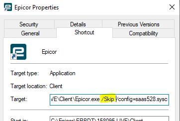

Add /Skip in properties.

Thanks for the input - not sure about adding switches that I don’t understand even though they work - that way leads to the dark side…
What does “/Skip”, skip?
It skips that verification as far as I understand.
