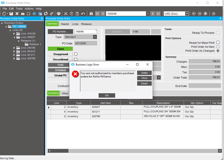

We have recently hired a new buyer. I created a new Buyer in Buyer Maintenance, Buyer ID, Approval ID, set the purchase limit, Approval Person, etc. However, they are still not able to edit other PO’s. Can someone please share where this setting is?
I have attached an example of what appears on their screen. Thank you for any insight!

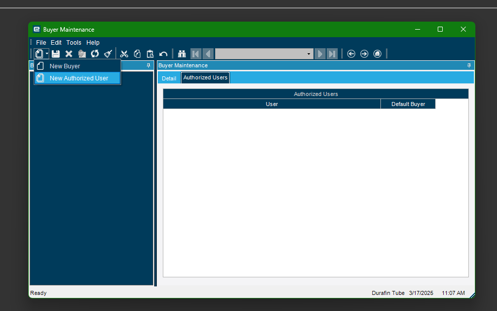

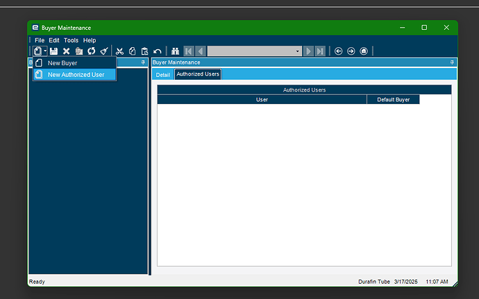

In order to work on a purchase order that belongs to buyer Kellie Williams, this person would need to be set up as authorized user for Kellie.
On Buyer Maintenance, there is a tab for Authorized Users:
And don’t forget to check default, that way the buyer field is populated automatically when the user adds a new PO
And a buyer has to be set up as an authorized buyer for themselves…
