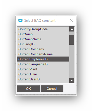

Like @Jason_Woods said, if your report is a BAQ Report, you can set a filter in the BAQ that will use the currently logged-in Employee’s ID. No interaction from the user required. You can also use the currently logged-in user ID as well.
On the table criteria, select “Special BAQ constant”:
