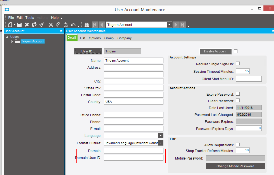

In User Account Maintenance in Epicor you can set the Domain / Windows User ID and Link it to the Epicor account
Then you should be able to pretty easily look up the current user in windows and figure out which user they are in Epicor. Now if you are using a “Shared” Computer where multiple users log in to Epicor but only a “Kiosk” type user is in Windows this approach won’t work.
@josecgomez.trigemco
There is no problem in doing the link (most users have the ID on that field.
The problem is that I need to know the Windows User ID when running the CR and match it with the field “Domain User ID”. So far, I have tried a bunch of functions / formulas but the don’t work.

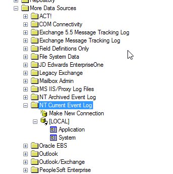

Create a connection to NT Current Event Log
Use [LOCAL]
For the source computer , pick Application
Then Filter the User Type / Domain and you should have it.
