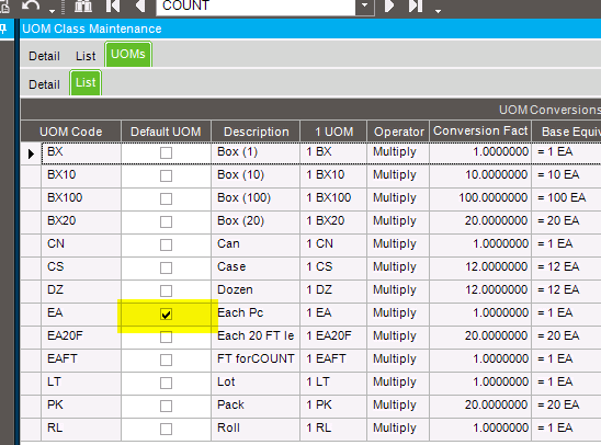

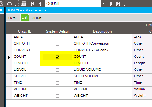

You can select a default in UOM Class Maintenance.
“System Default” on the UOM Class, and “Default UOM” (for that Class), on the UOMs tab.
