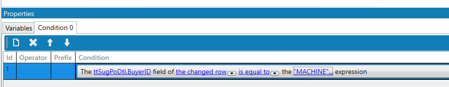

Our purchasing manager would like to be informed by email whenever a line where Buyer ID = “Machine Buyer” is generated in the New PO Suggestion module. Is it something that can automated using a BPM ?
Should not be too hard on a standard data directive on the SugPoDtl table.
You would just set a condition similar to this one ?
Yes, something like that. I originally was going to suggest the Added row, but in a standard directive it is after the update. It is possible you may have to put the condition in transaction for an added row and the email in a standard bpm that is triggered by the other bpm.

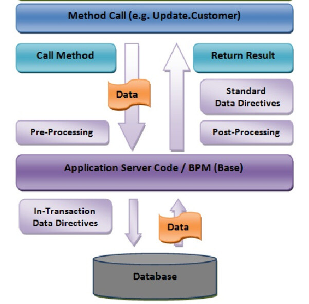

Within a Method Directive you can have a Post Processing Directive that only fires if it was enabled by a Pre Processing Directive. The same relationship can exist in Data Directives between In Transactions and Standard Directives.
For example, in an In Transaction Data Directive you could check you criteria to then determine if you will fire the Standard Data Directive or not.

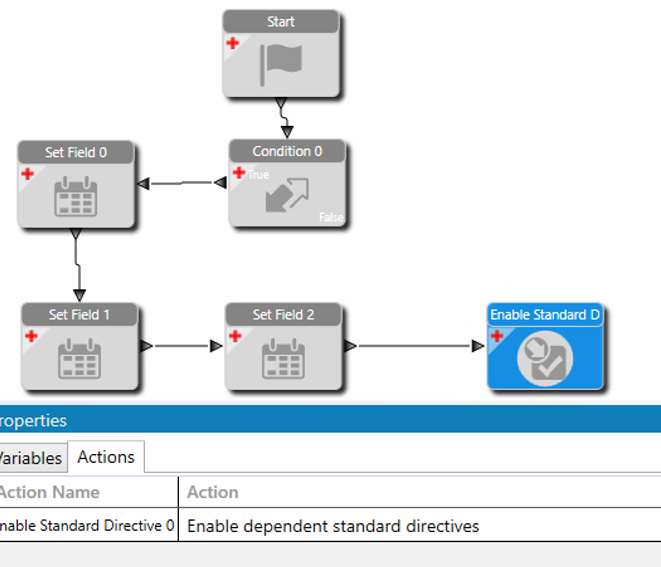

Here is an example. In this case I needed some data in the standard, so after the true condition I set a few fields and then added the enable Standard widget.

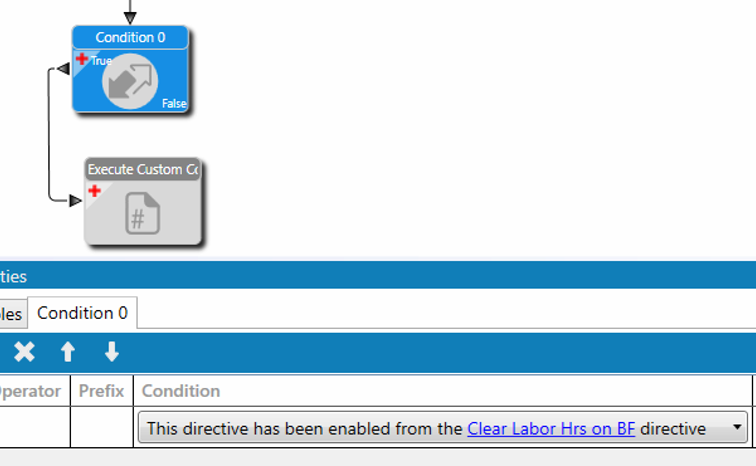

then in the standard directive the condition is this is enabled from the directive name.

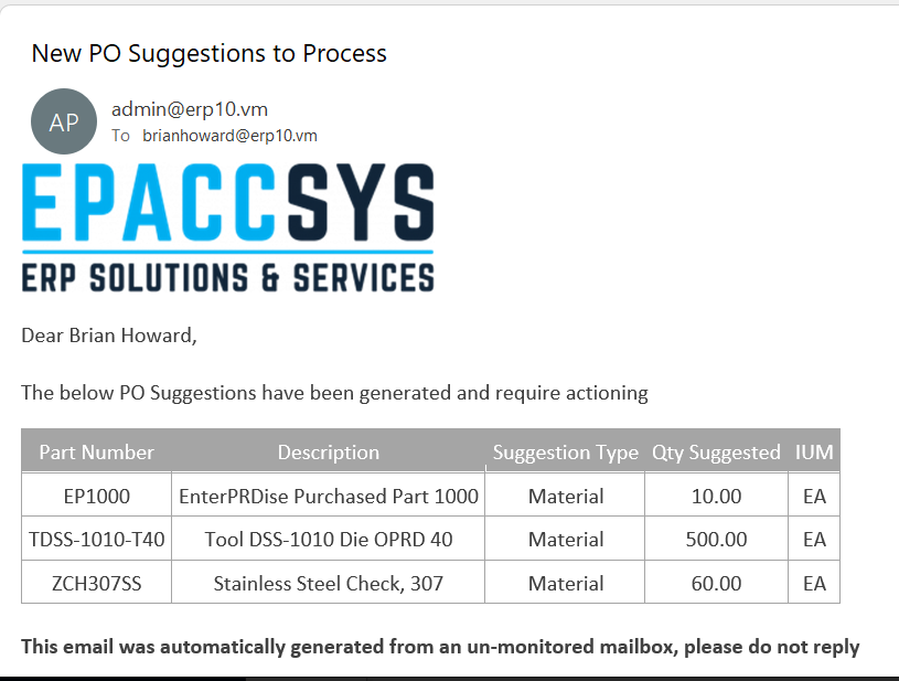

Attached in the .zip file is a BAQ and Epicor Function (11.2.400.14) that can be scheduled to let Buyers know that they have PO Suggestions to process.

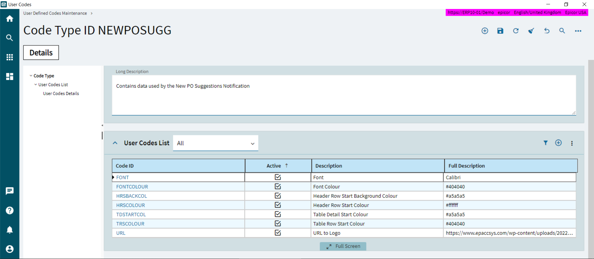

To use it you will need to setup a User Code as follows:

The function calls the BAQ and then uses the data from that and the User Code to format and send an HTML email with a table containing the New PO Suggestions:
You could also include a hyperlink in the Email to allow them to open PO Suggestions in a browser!
