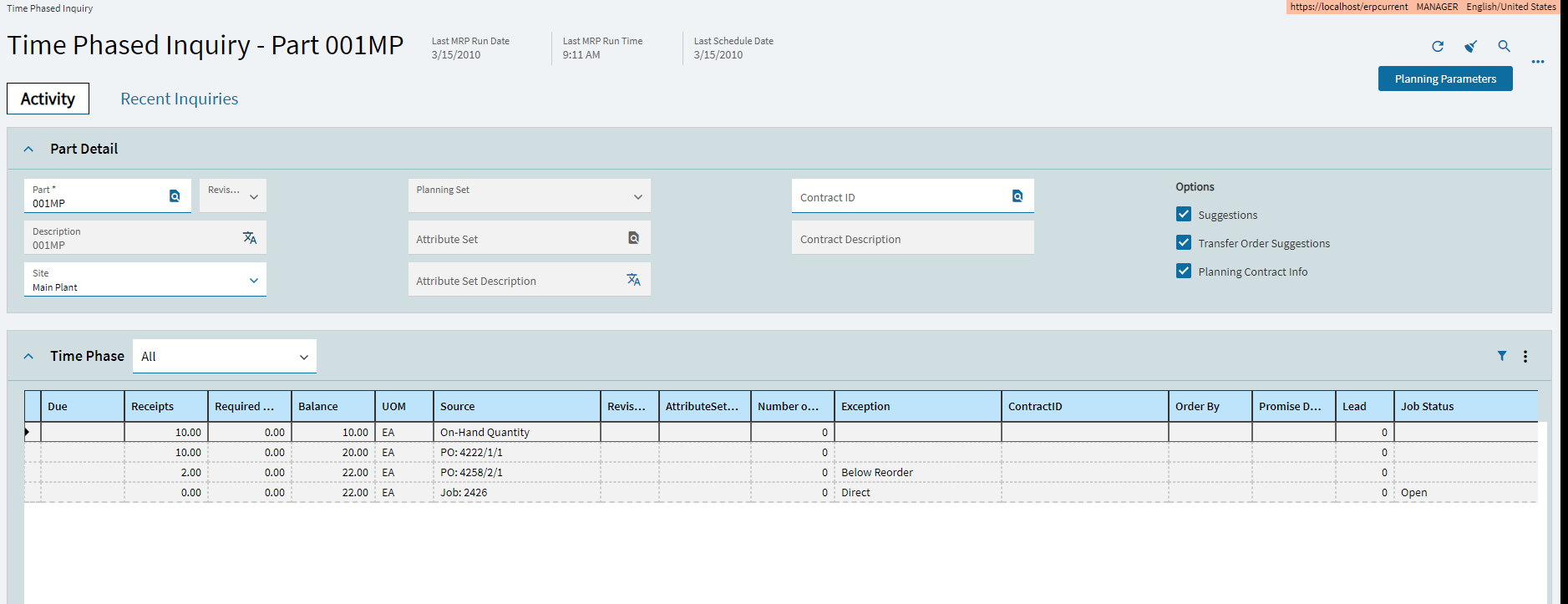

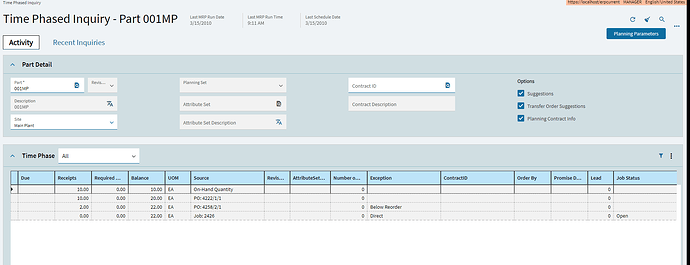

New Screen:

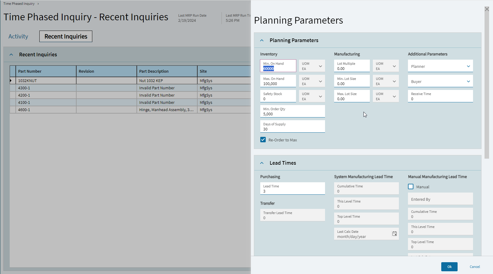

“Recent Inquiries” list, as well as Editable planning parameters slide out card that shows even more data than before:
meaning you can change the db part values or are you saying you can change what is displayed on the card?
you can press the planning parameters button, and the slide out card is displayed. If you have edit rights for the part program, then you will also have edit rights to change the values in the planning parameters. This makes editing much quicker, because you dont have to right-click/open with Part to edit the values. Once you have edited the values, you can then choose the menu option in Time Phased to run MRP again for that part, or run PO Suggestions for that part to replan based on your new planning parameters.

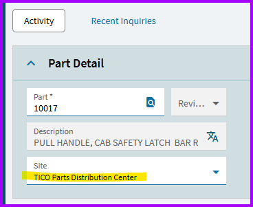

Another thing I observe is that a user with only access to site A (and no permissions to site B) can STILL edit the parameters for site B, simply by changing the site in the dropdown of Time Phase and then going to the Parameters.
I know, this would be the same for a user with Part Entry, but I mean how odd is it that a planner with no access to site B can change the planning settings for site B???

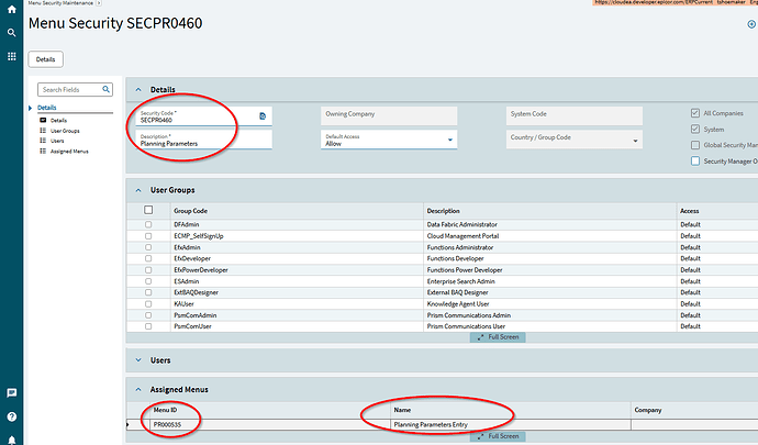

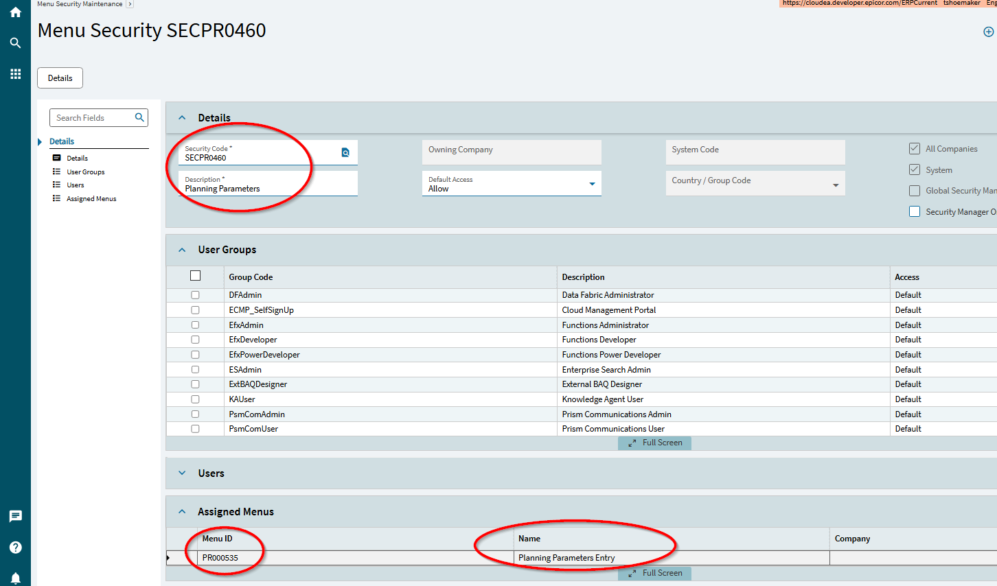

There is a special security group called SECPRO460 called “Planning Parameters”… it is associated with the menu option for “Planning Parameters Entry” which is what is executed when you choose that option in the Time Phased Inquiry.
If you go into the menu security, and lock down this menu, then only people you choose can change the parameters.

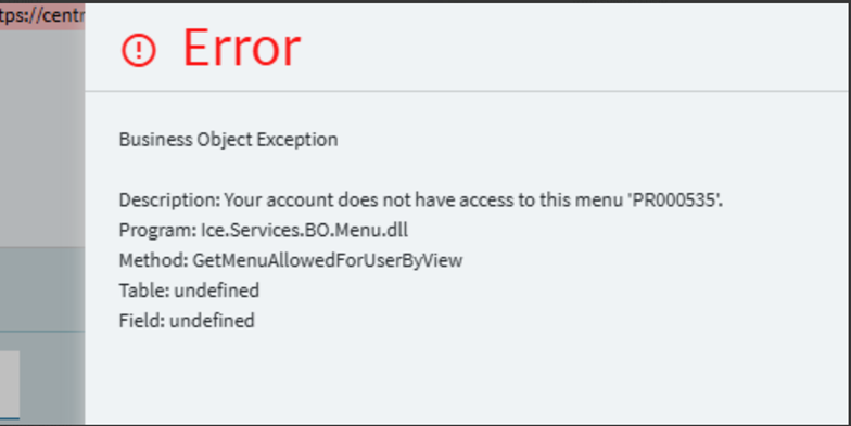

Problem is users who aren’t granted “Allow” in SECPR0460 can’t even SEE the planning parameters in Time Phase. Setting it to “Disallow” or “None” users get the error below when clicking the planning parameters button. We need users to be able to view the data just not change it.
