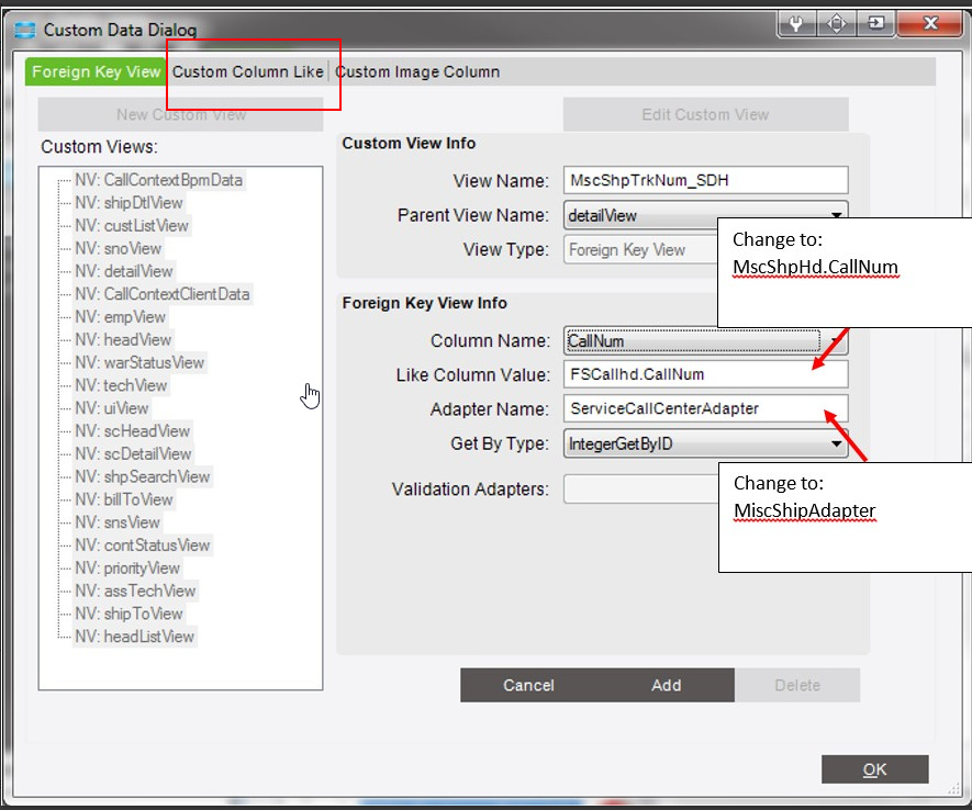

Hello,

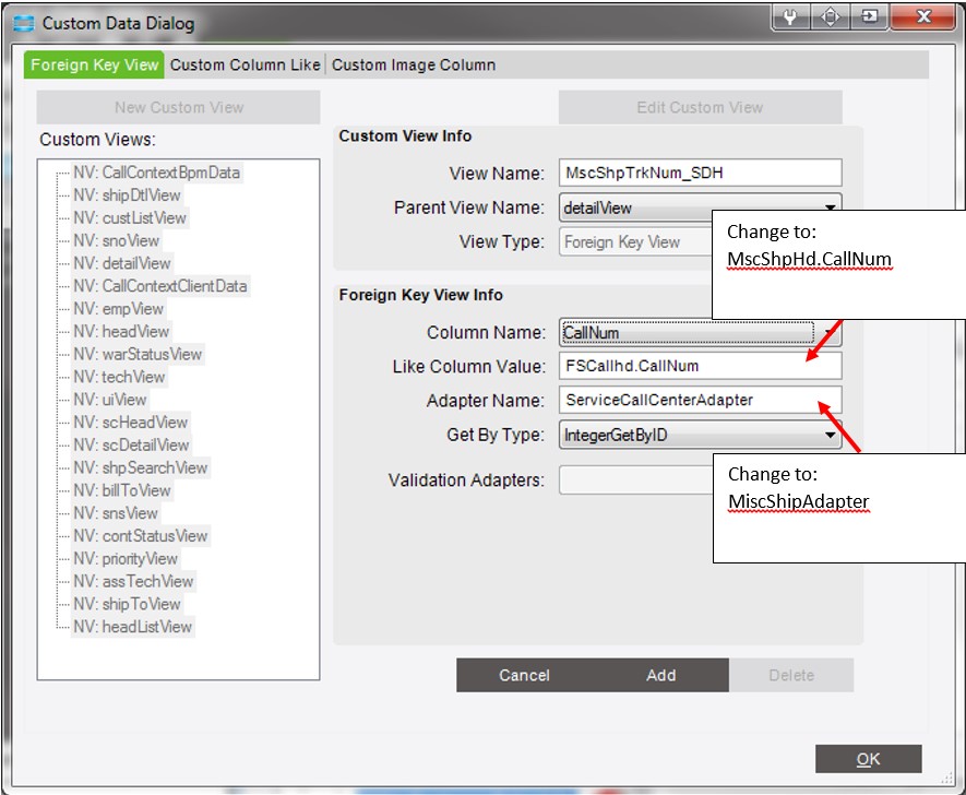

I tried the foreign key view (Option 2) and it kinda worked.
The only way I was able to access the Tracking number in the MscShpHd table was to select the field ‘PackNum’.
Unfortunately, I need to key off the field ‘CallNum’ and it goes to the FSCallHd Table.
Is there a way to Change CallNum to use the MscShpHd table?
So your MiscPack num is the same as the CallNum?
You can add a Custtom Like value and change it from FSCallhd.CallNum to the Shiphead.PackNum

What I meant was that when I was going through ParentView Name -> DetailView: PackNum was the only column name that pointed to the MscShpHd table where the tracking number is saved to.
What I need to key the connection between the Service call screen and the Misc Ship screen is the CallNum field, not PackNum.
When I select CallNum in the Column Name, it points to FSCallhd.CallNum.
Is there a way to have it connect to the MscShpHD table field of CallNum instead of the original one?
How do you add a Custom Like Value?
Thank you for your swift replies, I really appreciate it!

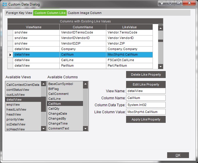

Use the Custom Column Like tab
Find the field you want to change and change the Like value to the right one. It should me MiscShip.PackNum or something like that (Not sure on that one get the value from the Misc Shipment Table)
This will work as long as the CallNum is the same as the MiscShip.PackNum
When I go into ‘Custom Column Like’ tab and Edit CallNum to use the MscShpHd table and go to create foriegn key view, the option disappears from my selection list.
BTW, PackNum and CallNum are not related to each other, they are just both fields in both tables.
Any ideas?
Ok I got it, that’s becasue that’s not a Queryable field. I thought you had made the PackNum be the same as the call Num. Instead you are using the CallNum fields in the Shipment table…FKV’s only work with primary keys. In this case you’ll have to use the BPM option.

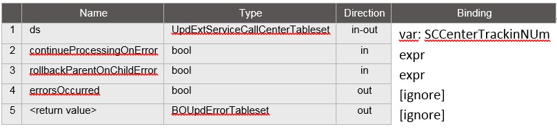

  4. Set up ‘Invoke BO Method’ like this:
  5. Invoke ‘Erp.ServiceCallCenter.UpdateExt’ BO method with ‘specified parameters’.
  6. specified parameters are:
