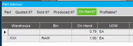

As I was watching DMT chug away at 10K records, I saw a handful of issues come up. There are a few parts with Qty on hand, but no warehouse code. Also, some parts on hand with a warehouse code, but no bin number. DMT wouldn’t adjust these quantities due to the missing warehouse/bin info. I also could not adjust the quantities through Quantity Adjust. DMT successfully updated over 10k parts with Quantity Adjustment in just over 1.5 hours.

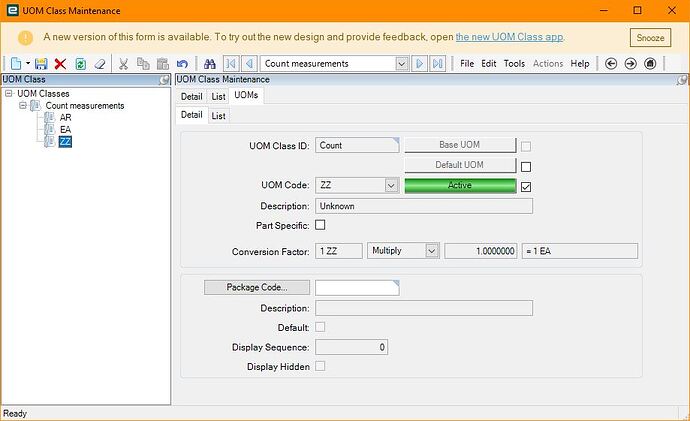

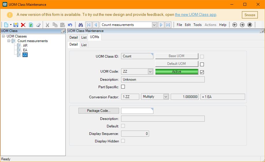

My UOM does have an unknown, but the code is ZZ not UNKN.
I tried Refresh PartBin QOH From PartTran. This did remove my record containing the blank bin. Is this the only way to do it? What about that weird UNKN UOM? Do I need a datafix, or is there a repair process that will take care of those?
