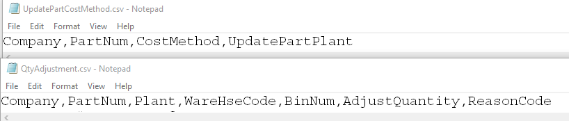

I pulled the parts out of inventory with the DMT Management-Inventory-Adjustments-Quantity Adjustment template (during a time when no inventory was moving). Then used DMT Management-Inventory-Part-Part template to update the cost method (included the field “UpdatePartPlant” so the site cost methods were updated too). Then adjusted everything back in with the same qty adjustment template.
So the inventory was adjusted out at our standard cost, and adjusted back in at our average cost. Any discrepancy in the two would hit the books. The reason code (and associated GL control) selected during the adjustments will dictate which accounts get hit with the discrepancy.

Yes I pulled the PartBin info into a BAQ to get the quantities then copied it into my DMT template. Here’s the DMT columns I used:
It looks like I have to pull Plant from the PartRev table. What did you use for Plant?
I must’ve named the BAQ something I can’t remember or I didn’t save it sorry. I’m pretty sure I pulled the Plant in using the WarehouseCode on PartBin and then Warehse table. I don’t think the revision is maintained when something gets put into inventory.
