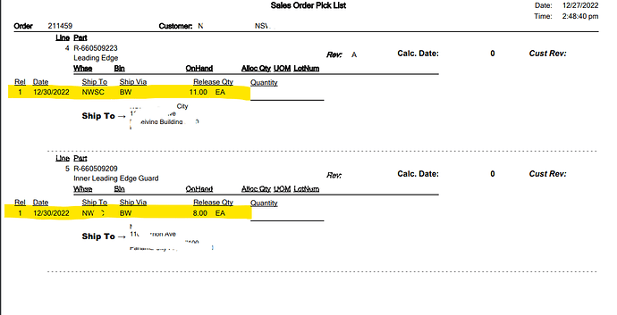

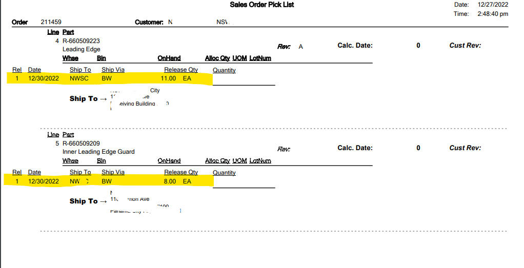

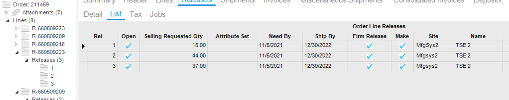

Would someone be able to explain why Epicor will not show all the releases on a pick list. Notice my screenshots there show 3 releases for both lines 4 and 5, but the pick list only shows one release for those lines.
Even though this pick list here is a custom one, the same thing happens on the default report.

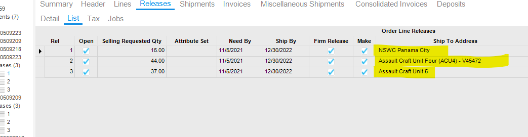

Anything different for the releases other than the quantities? Are you shipping to different addresses on each release?
all going to the same address
correction, they have different addresses for each release.
Are the releases open?
Yes, just double checked
Dates? The pick list is date limited, right?
Oops - didn’t read that very well. All the same date.
Also, I think drop-ships don’t show, but I assume that’s not the issue here. Just FYI.
I tried a test order and everything came through in the stock pick list. Is the request date the same for all three releases? If I adjust those and my pick report falls within the range I don’t get all of the releases. The need by date doesn’t seem to affect the report.

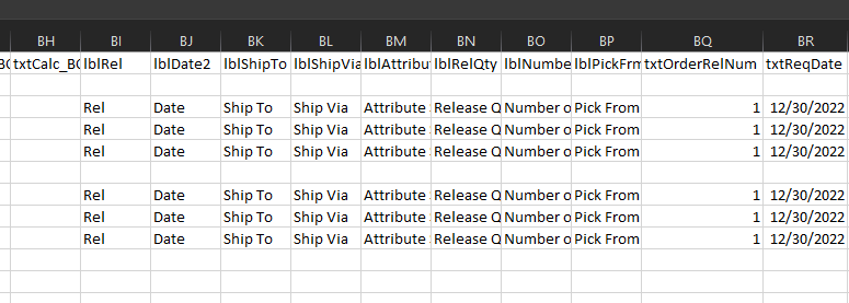

I would start troubleshooting the output from the report program. Can you generate the report and then look at the report data to see what data is being generated? That may help eliminate what you need to look at.
You referring to something like this? Because the report data only shows one release for the 2 lines.
This is data from the default report

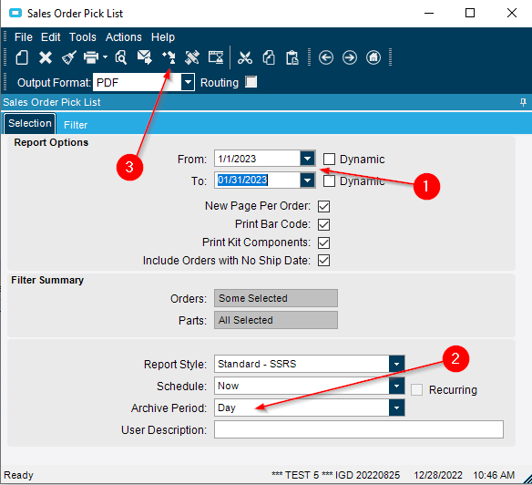

When you generate a report, it creates temporary tables in your report database:
  1. Put in the dates.
  2. Choose a day for archive time.
  3. Click Generate Only.
When it generates you’ll get the following in your report monitor:
If you then look in your report database via SSMS you can see the following table:
This table should show all of the releases. If it does not, then the data is getting filtered out from Epicor. If it does, then your report is filtering them out. My guess is they will not be showing since they don’t show up in the stock report either, but it’s good to check.
