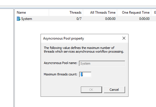

In Service Connect, under Connectivity, then Asynchronous Pools, we can right-click on the single instance and open Properties…there is a value there shown as “Maximum threads count”, which is set to 7, but that doesn’t seem to have any relation to the number of Epicor sessions that get opened.

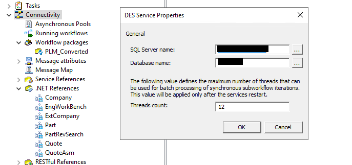

Right-clicking on Connectivity and selecting Properties shows a “threads count” of 12, but that appears to be related to the Service Connect side, not to the Epicor side of things.

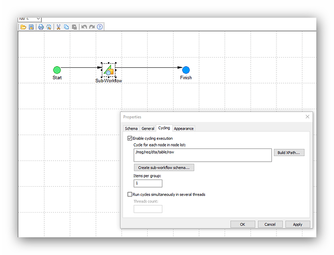

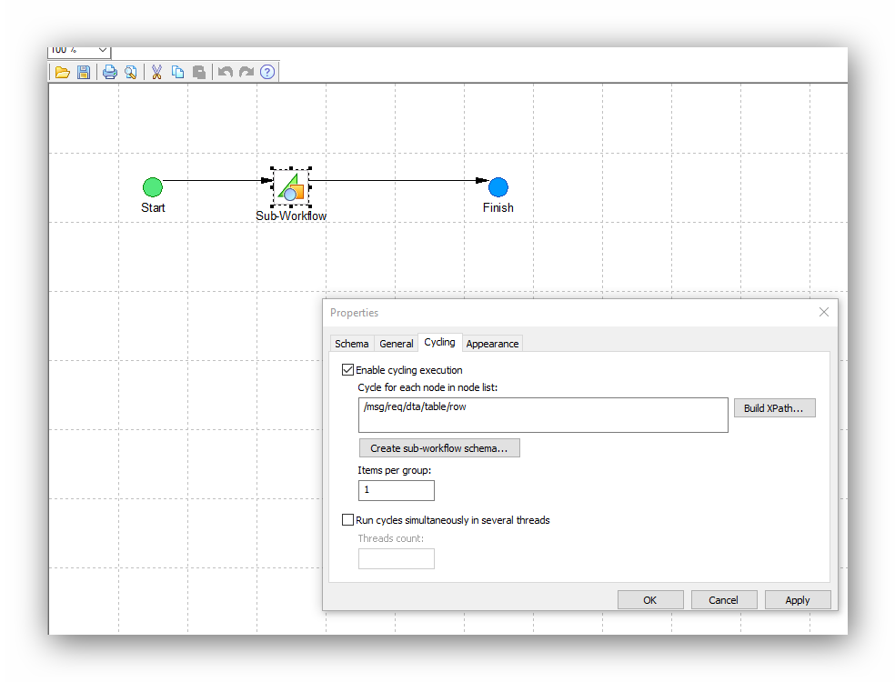

I’m nowhere near a Service Connect expert, but our Workflow has a starting workflow and then a sub-workflow that is called for each record in the input file. In that sub-workflow call, we have it set so it does not “Run cycles simultaneously in several threads”. Not sure if your workflows are set up the same way, but I hope this helps. We had the same issue where Service Connect was consuming all of our licenses until we changed this.
Thank you Tyler…unfortunately our workflows aren’t set up like that, but it does look exactly what we’re looking for. I just thought that this would be defined a little better elsewhere.

The number of threads on the first screen shot (for the asynchronous pool System) controls how many threads Service Connect (SC) is allowed to use for independent asynchronous processing of messages (concurrency of synchronous calls to SC is not restricted).

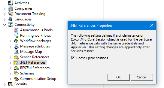

The session is opened with the first invocation of Epicor .NET reference by the workflow, and is released when the workflow completes, unless session caching is enabled.
Session caching allows to save on time needed to open the session, if SC is under heavy load, keeping the session open between workflow executions for some time (session is only reused if appServer/user/password/company/… are the same).
The behavior you describe (if workflows use .NET references) may be caused by the session cache mis-behaving, and not releasing/not reusing the Epicor session in time.
To see whether that is the case, you can use SC administration console:
  1. Expand Connectivity
  2. Select .NET References
  3. Right-click .NET References and select Properties
  4. In .NET References Properties dialog, un-check Cache Epicor sessions
  5. Restart SC services
    Note: restarting SC services breaks the processing of the messages being processed at that time, so, you need to pick up such time when messages are not being processed. If the integration used input channels to pick up incoming messages, then disabling input channels (you will need to re-enable them after services are restarted) and checking with Document Tracking / Events\All Logs in SC Administration Console would allow ensuring that no messages are under processing at a particular time).
