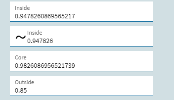

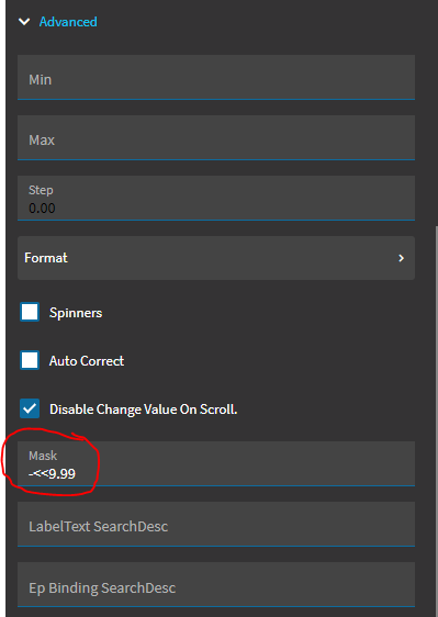

Here’s an example you can try… this was a numeric box. Try putting your format in the Mask to limit the number of visible decimal places:

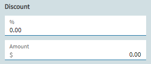

I don’t know if you can add a % sign to the value or not… looking at base fields on forms (like Sales Orders), it looks like Epicor just uses the “%” in the field Label:
