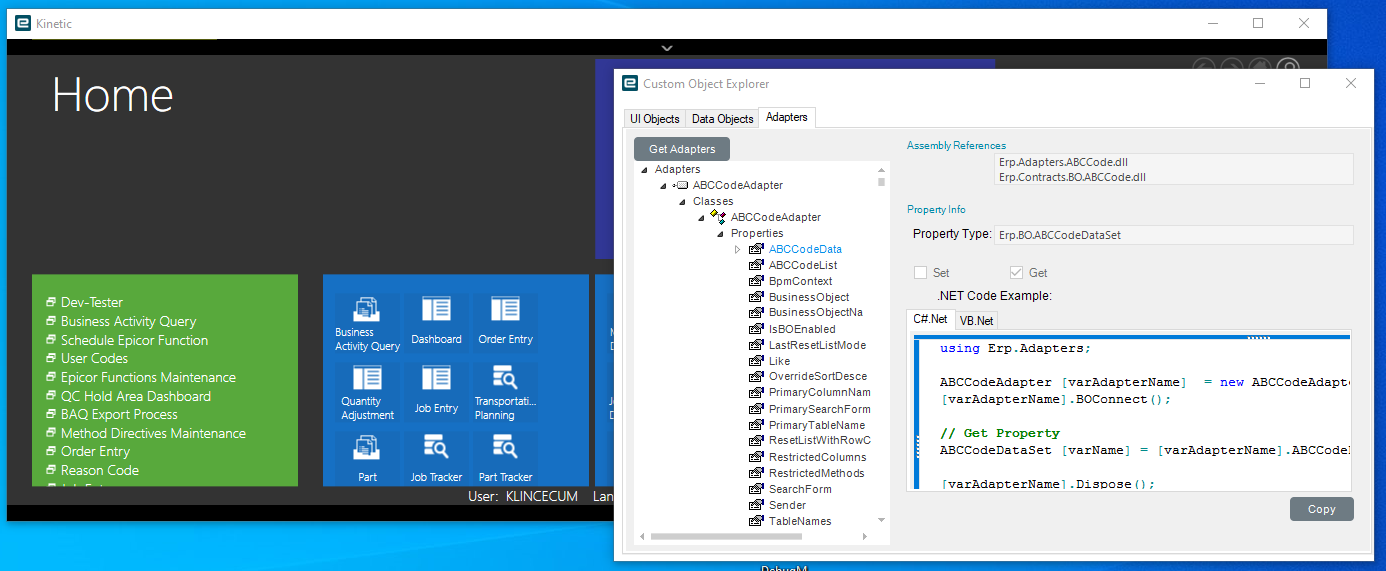

Make a customization for UD01Form, and put this code in the script.
Make a shortcut and Bob’s your uncle.
The Data Objects Tab won’t work.
This is normally tied to a form and we closed it ![]()
public class Script
UD01Form.Shown += UD01Form_Shown;
UD01Form.Shown -= UD01Form_Shown;
private void UD01Form_Load(object sender, EventArgs args)
UD01Form.Visible = false;
CustomObjectExplorerDialog objExplorer = new CustomObjectExplorerDialog(UD01Form, oTrans, csm);
objExplorer.Show();
private void UD01Form_Shown(object sender, EventArgs e)
UD01Form.Close();
That code could easily be modified to add a button to any classic form you like,
with the object explorer specific to the form you are in. ![]()
Dang, thanks for this! Should be a standard feature imo but this will suffice!
