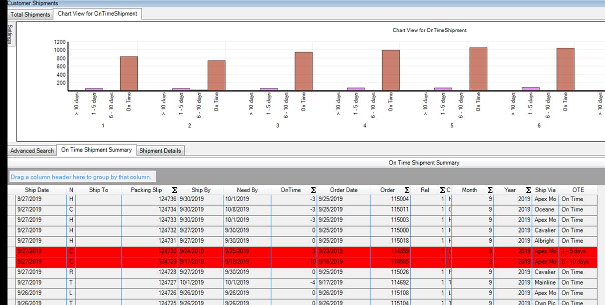

We designed our own BAQ and Dashboard. The dashboard also prepares the chart as shown below. If you want I can load it on the site.

looks nice,
would you be able to share the BAQ file?
BAQ attached. Version 10.1.600OnTimeShipment.baq (9.5 KB)
this is awesome thank you very much! it worked great
Vinay… would it be possible for you to share a copy of your dashboard as well?
Hi John,
Dashboard Definition attached. Ver 10.1.600.19
Vinay Kamboj
OnTimeShipmentTrackerDashboard.dbd (386.8 KB)
Thanks Vanay. Like it!

You should be able to download the BAQ file and then import it using the BAQ designer. You could also create an SSRS report using the BAQ Report designer using the same BAQ as a datasource.
Keep in mind to use the dashboard you will need to keep the BAQ ID the same as the author created it as (POL-ONTIMESHIPMENT).
Thanks! still works great (imported in 2022, Epicor 10.2)
Thanks for your BAQ, worked for me as well! great support
