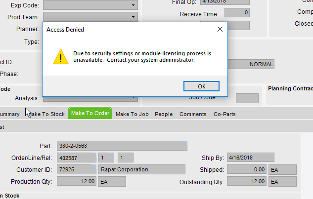

Here’s another one that shows up when she tries to right click open with for order entry.
(I’m sure it’s something I screwed up, I just can’t figure out what)

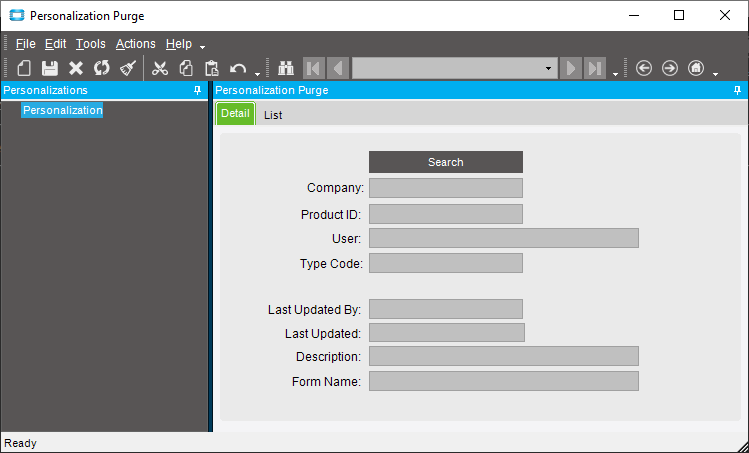

Have you actually gone into the Personalization Purge form and searched to see if she has anything out there on the Sales Order Entry form? Just a thought…
I can run her personalization as myself and it works fine. I did delete her personalization from the developer screen, but I’ll try the purge as well.
no go on the purge

This type of Security is generally handled on the Client with Data retrieved and cached from the Server. It sounds like you are getting the Message and then the form opens anyway? That type of behavior indicates you have Security setup on the BO Methods or on the Data Table or Key Fields.
It opens, but then is all greyed out, so the user can’t do anything. If I right click on an order number from a job tracker screen, it immediately comes up with the error message (and doesn’t open the screen)
That is where I am looking, but I cannot see anything that would be blocking this user.
