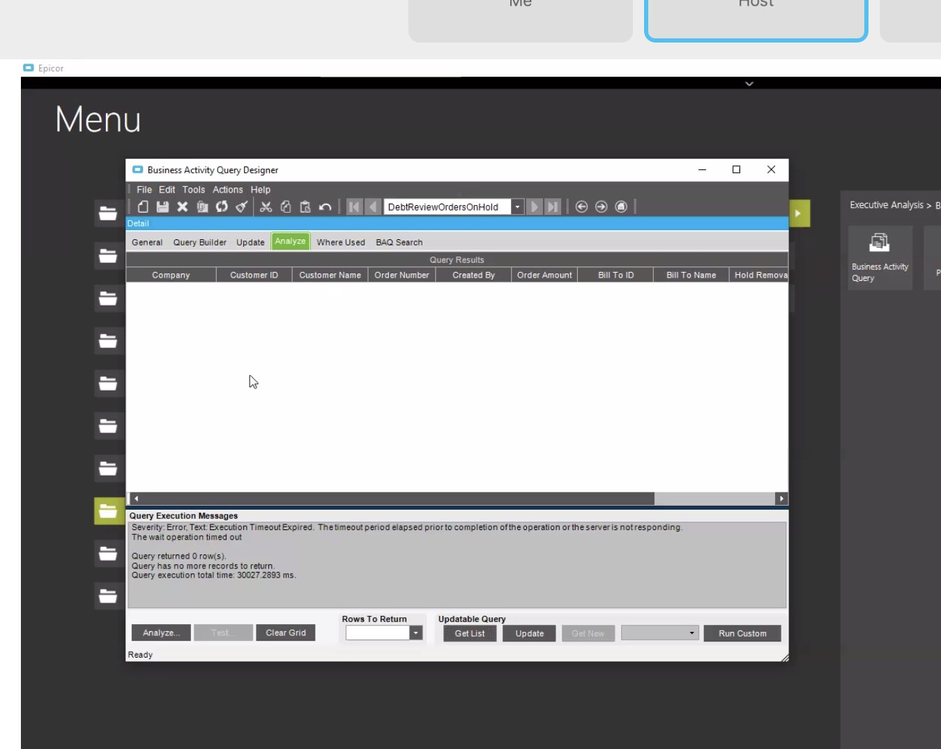

This one is odd. We did an upgrade from 10.2.400 to 10.2.700 and now this one user can’t run a BAQ that he was able to run before. Other people CAN run it (myself included). We tried looking at security, temporarily giving him security manager access so he could run the BAQ directly (normally it’s through a dashboard) and the BAQ timed out on him. When I run it, it comes back in 307 ms.
He gets this error when he runs it.

Is that during an update or even when just doing the Get List?
During Get List

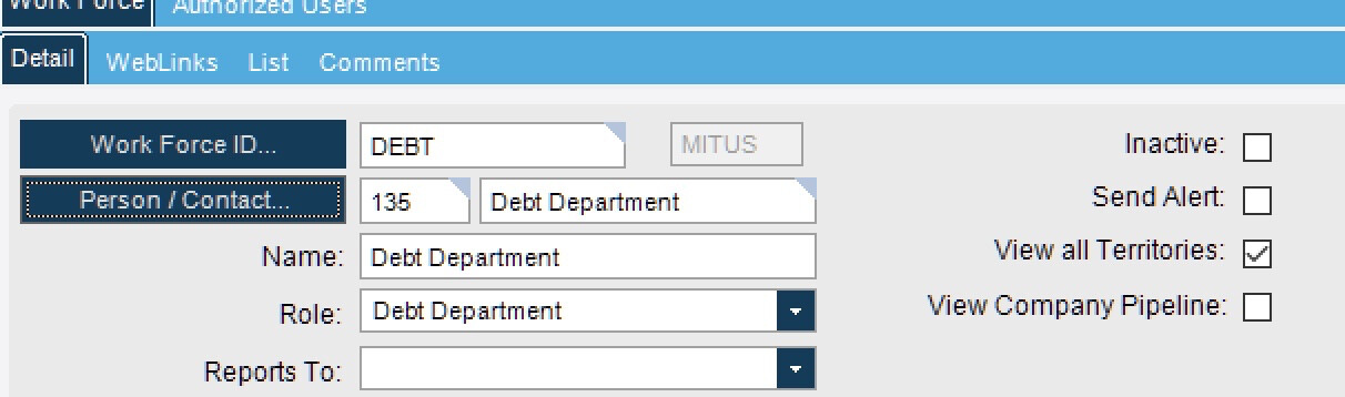

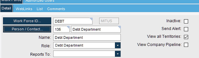

if you have CRM, then the person running the BAQ will have different results depending on their assigned workforce ID. This is because CRM adds additional filters to every query when the Customer (and/or OrderHed?) tables are on the query. This is all done in the name of SalesPerson Security.
SO, you should look at the person to see what sales region / territory they have assigned.
We do have some people with a CRM license and some that don’t have it. The only work force ID they have access to is a shared one with all territories.

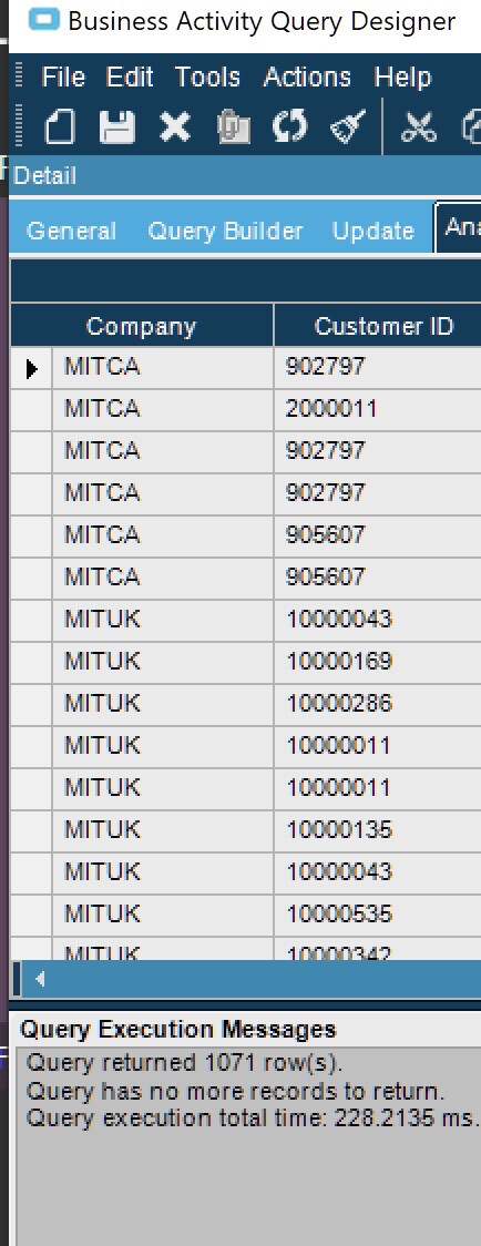

The problem is that when I run it, or other people in IT (besides our boss) run it, it comes back very quickly. 247ms this last time. So why is it timing out only for them?

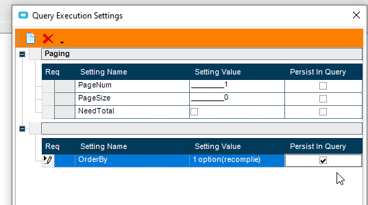

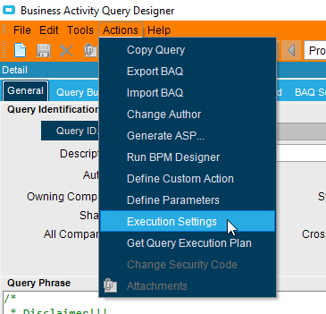

Could be a cache thing. In the BAQ try going to the execution settings, add a setting, like shown and see if it fixes it.

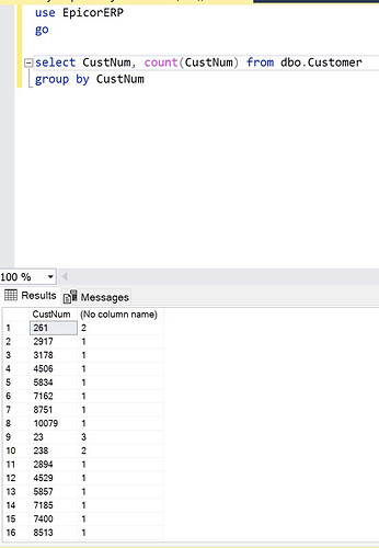

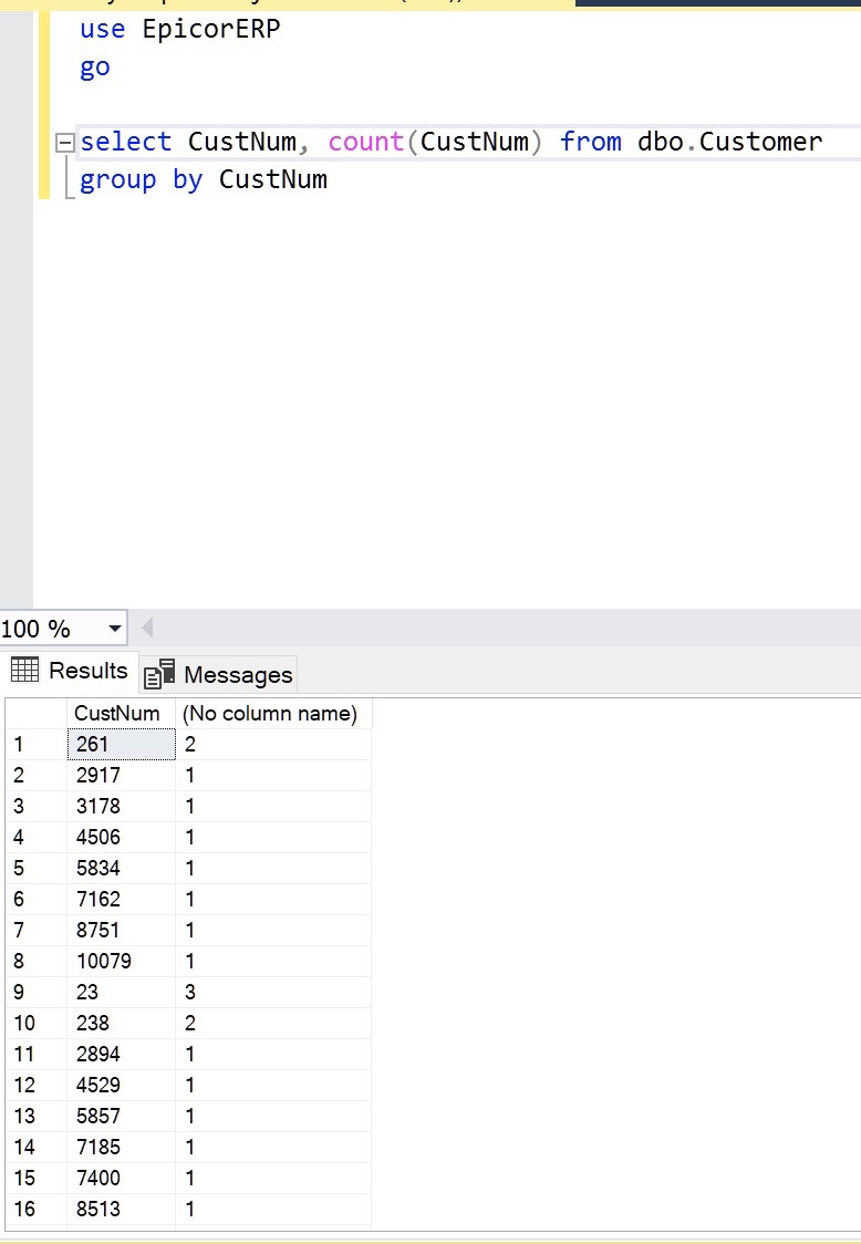

I’m pretty sure that it’s just the join to customer where the company join slows things down. Since CustNum is unique to the whole database, you can usually get by without having company in the join to the customer table.
We have multiple Companies, and the key is Company, CustNum. Going into SQL directly, CustNum is NOT unique by itself. If it was, then yes, we could avoid using Company :slight_smile:
Interesting! I thought it was. I stand corrected.

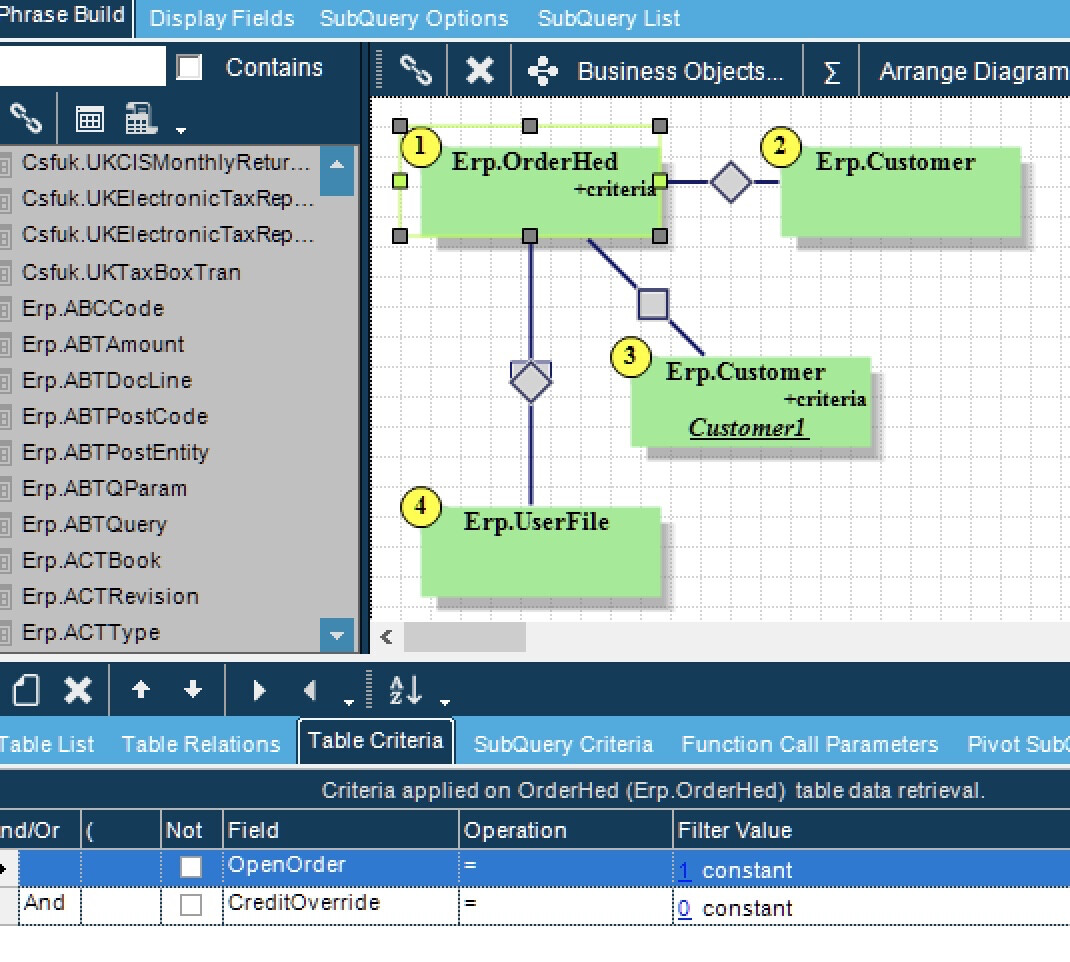

I’m assuming the expression above was generated for a design that used Table Criteria on OrderHed. Is that the case @MLamkin ?
Yes, the actual BAQ design is

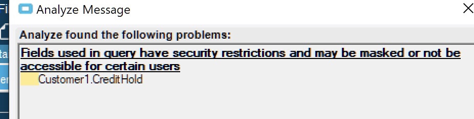

If I were writing the raw SQL I’m sure it could be coded more efficiently, but I have found that in nearly all cases, SQL server itself is almost never where things are slow. I copied and pasted that code into a query window and tried it, the execution time displayed was 00:00:01, in otherwords, <= 1 second.
For this query, one could possibly speed it up by using the link from OrderHed to Customer1 (which is where the other credit hold factor we need is) and then linking to the other tables. And when we were testing, it’s the CreditHold field from Customer1 which is the big issue (there’s a warning in BAQ about security for it), removing a reference to it made the query work fast for everyone.
The combination of Cross Company and accessing that field
seems to be what is making it slow for some people and not for others.
