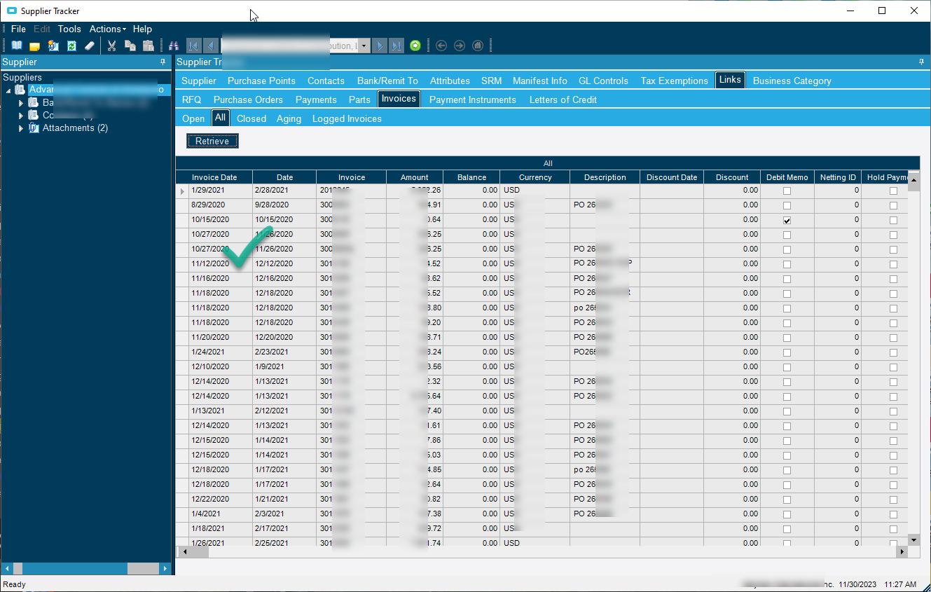

We have a strange situation where one of our users can’t see the Invoices from the Supplier Tracker form. If you are in the Supplier Tracker, load a supplier, then go to Links > Invoices > All, you should see all of the invoices for that supplier. And this works for all users. One user, however does not see any invoices. She is the purchasing manager and has the required permissions. It almost seems like a form or screen issue but I deleted the users personalizations for that screen. We also tried logging into Epicor from a different PC and the issue is still there. When another user with similar permissions/groups tries it, it works, and also works for me. Any ideas on what this could be?
This is what the screen should look like:
But the grid is empty for the problem user.

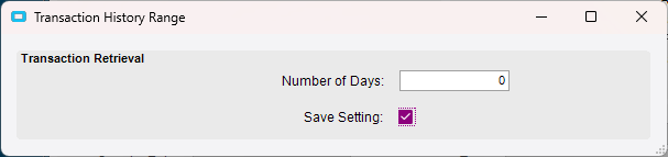

Have the affected user try this:
  • Open Supplier Tracker
  • Actions > Transaction History Range
  • Set the Number of Days to 0
  • Check Save Settings
  • Refresh
  • Party at a problem solved?
That worked! Thanks!!
