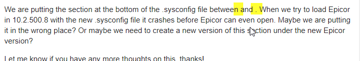

We are putting the section at the bottom of the .sysconfig file between and . When we try to load Epicor in 10.2.500.8 with the new .sysconfig file it crashes before Epicor can even open. Maybe we are putting it in the wrong place? Or maybe we need to create a new version of this section under the new Epicor version?

You need to escape the XML formatted text. use a single grave before an after for in-line escaping:
to show as
Between <Process > ... </Process>
(I’m talking about posting here, and not in the sysconfig file)

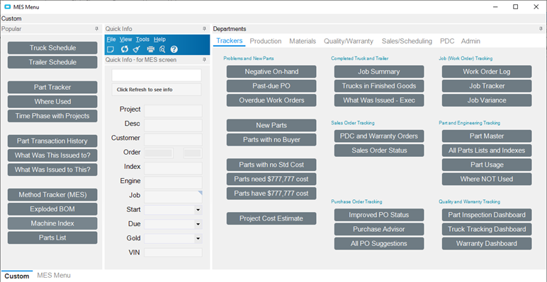

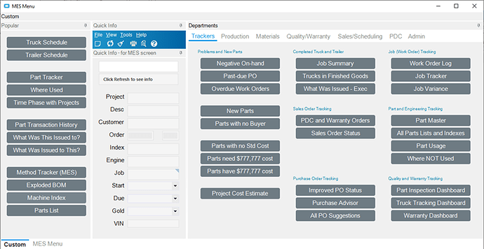

Couldn’t you customize classic MES and launch that?
We don’t use it anymore, but I had a dashboard embedded in my MES customization. You could make it the whole thing, I guess.
And to clarify, the client configuration specifies which MES customization to use - if you needed to have multiple.
