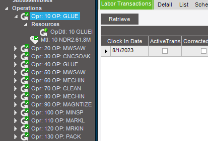

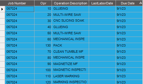

any idea why that field wouldn’t be populating? I had looked at that and its blank for almost everything. If I look at the job in Job Tracker and look at the operations they are marked as completed and have labor transaction data but nothing in the LastLaborDate field.
Out of 800K of JobOper records since 2014 I do have 1538 that do not have LastLaborDate, but they seem to be whole jobs that are empty. Even my backflushed operations have a date.
