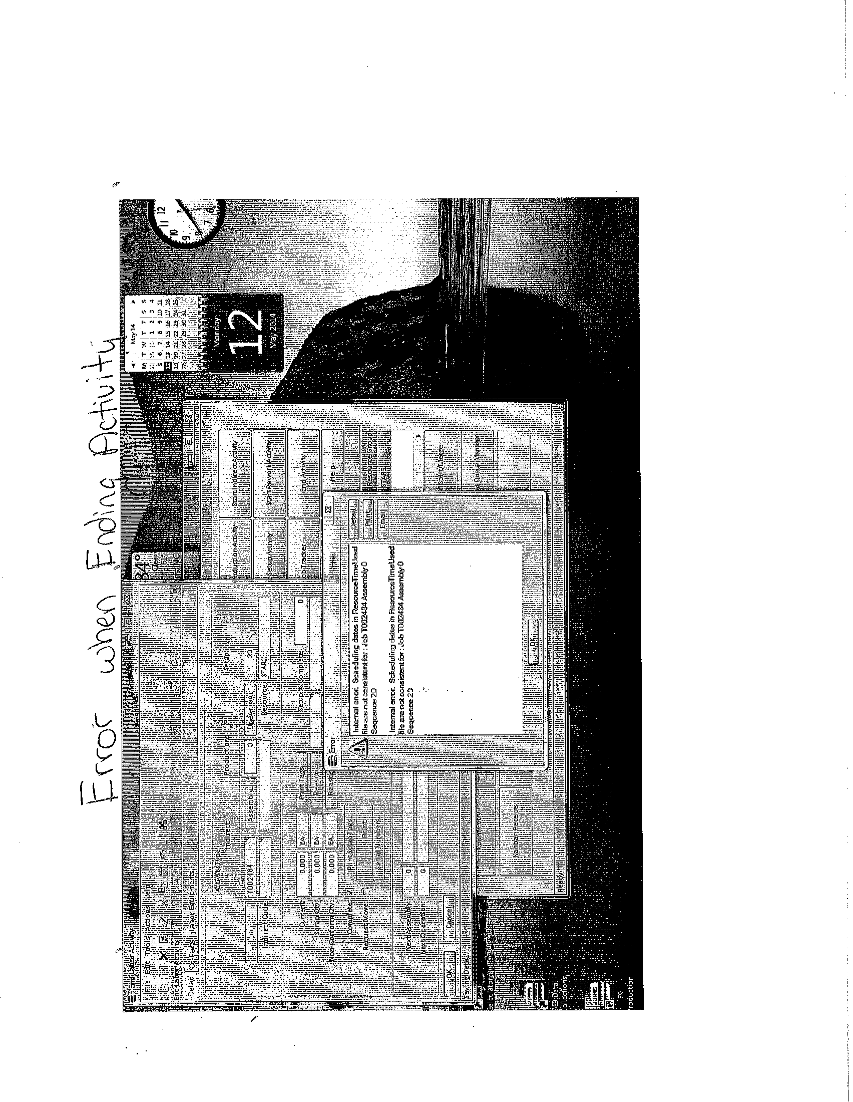

Operator can not clock out. Epicor throwing record-locked error
We have a user who cannot clock out of any job she is currently in. When she tries to clock out, the MES program spins for about 3 minutes and then throws a (7243) (7241) error message. I tried running Conversion Program 8920 on the server to manually clock her out of the jobs but Epicor throws a “record lock” message when I try to change the “yes” to “no”. Does anyone know of a way out of this or what might have caused it in the first place?? I’ve waited 4 hours now but the record(s) still appear to be locked and she cannot clock out at all. No other operators are having this issue. Any ideas???

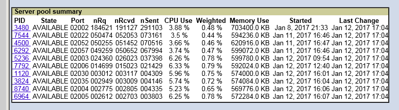

I did notice in the App Server connections on our Epicor server, I have a “rogue” connection that has a status of “SENDING” where all of the other connections just say “CONNECTED”. It is coming from the very computer that originally had the issue this morning. I completely shutdown this PC but this App Server “sending” connection stays. Could this be part of the problem? Is there any way to “close” this one “sending” connection without having to reboot the server?
Mike,
There is a way and I’m trying to remember how (other than rebooting the server) to kill those connections. It’s been a few years since I have had to do it and my memory is not going back that far at the moment.

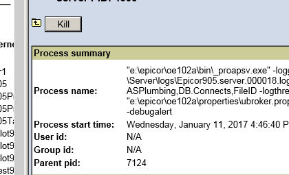

Can you cancel the PID connection that is hung? When you restarted the AppServer, did the date change on the “sending” connection to the date you restarted the appserver?
Yes, you can click on the link and kill that appserver. I have mine fathom open all of the time to monitor sending appservers that were abandoned. You do have to be careful the capture wip process is not running as it can be sending for as much as an hour.

Thanks Greg, once I kill it, do I need to do anything else in order for it to be used again?

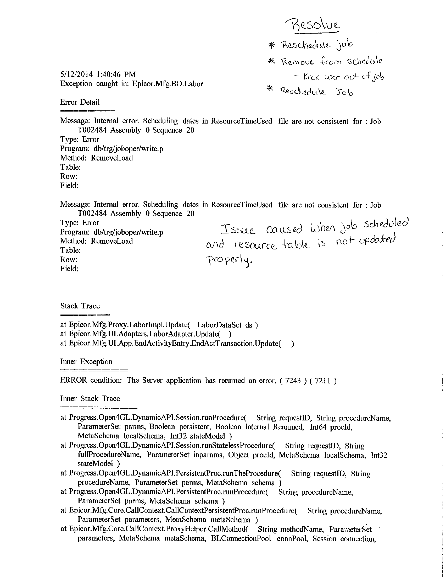

I think I have seen this before. I believe I created a little tech note how it was fixed. let me dig for it and see if I can find it. Thanks
