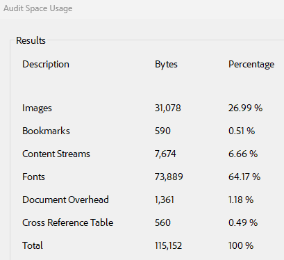

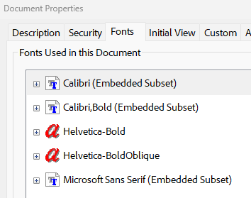

Report Style (using Calibri as my main font):
Report Style (after converting everything I could find to Arial):
And there’s still a Sans Serif hiding in there somewhere :imp:
But… proof of concept… pretty dramatic decrease in overall file size!
