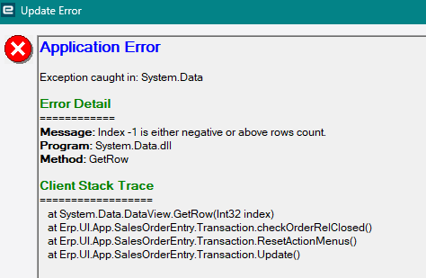

After upgrade to 2024.1.5 when we use paste insert to add lines in Order entry we get error Index -1 is either negative or above rows count. I disabled all related BPM’s disabled customizations, deleted personalizations. but it is the same. Anyone else noticed the same issue?
Where is the paste insert data coming from?
Are you sure it’s in the correct format? They could have changed something.
You can test by copying some lines from the grid, then delete the lines, and paste insert them back in.
Did that without any changes and i get this error. tested PO screen no issues. I think i disabled all modifications, so I am curious if I missed something or this is a bug
So this was a bug and fix will be released with 2024.2 version
Hi There. We have the same issue. Did you confirm with Epicor that this is a bug that will be solved in 2024.2? We are getting same issue with 2024.1 so far.
If you were able to solve it, please share the solution. Thank you.
yes it was epicor issue and i think they fixed with some of the update. It is working for us now
@Justas did you fix this going to 2024.1.5 or did you have to go to 2024.2?
hi,
I do not remember at which version it was fixed but I think it was prior 2024.2
