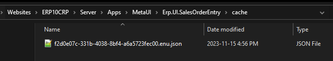

For the cache, I don’t understand why it is both stored in the database and into MetaUI files. The conversion workbench task 191 migrates MetaUI JSON files into the database (Ice.XXXDef). Once it is done and KineticUseFileSystemNotDB is set to false, I don’t think these files are being used anymore.
I just tried to load 3 project entries at the same time and could not replicate the issue. Only one JSON file gets generated per language in the cache folder.

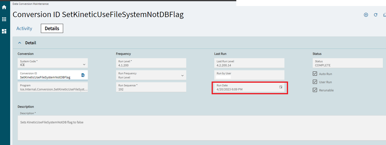

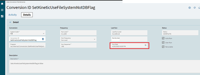

Epicor should really give more details about this parameter. Open up Conversion Workbench. Search for task 192 “SetKineticUseFileSystemNotDBFlag”.
This task sets the parameter KineticUseFileSystemNotDB flag to false.
false = use DB (Ice.XXXDef)
true = use filesystem (Meta UI folder)
A year ago, we went “all in” Kinetic web. We had unexpected issues with Kinetic dashboards and layers. I had to decompile Epicor code to understand that the parameter KineticUseFileSystemNotDB had a huge impact on how they handle Kinetic forms. Ours was set to true.
We ran the conversion task 191 to migrate MetaUI JSON files to DB, and then, task 192 to set the KineticUseFileSystemNotDB to false (permanently).
No issues since, except for the cache being the only thing that Epicor seems to manage both via the MetaUI folder and the database.
EDIT: I think you will get much less files written to this MetaUI folder (only the cache). It may as well improve the performance. I suggest getting the opinion of others before doing that move.

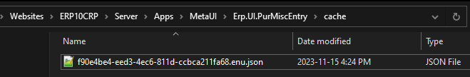

Not sure about the 3 sessions since I just used 2 different users in 2 different web browsers (Chrome and Firefox) and both of them had the same language AND personnalization (Which is none):
  • Open any menu (In my example, Misc Charge / Credit)
  • ctrl + alt + i on only one of the user will clear the cache file on the server for its corresponding language of the menu
  • Open the menu by the 2 users at the same time (1-2 seconds apart). The 1st user will see the program but the 2nd user wil get an ‘Business Layer Exception undefined’ error.
  • The crazy thing is that if the 1st user, who was able to access the menu refresh his screen or go back to his home page and reopen the same menu try to access it, it won’t work. In fact, I think it won’t work for anyone who has the same language that the locked cache file

  • The 1st user who loads the menu will create an response.(language).(Menu) file in the cache folder
  • The 2nd user who loads the menu will replace the existing cache file with a new response.(language).(Menu) file in the cache folder
  • Both of those users are able to access the menu because there wasn’t any conflict with the files since it’s not generating the same one
  • So, in the end, only 1 cache seems to be stored in the MetaUI/Cache folder per menu
If the 2 users have different personnalizations, there will only be 1 cache file and admitting that the last user that opened the menu is the one with the personnalization, it will have a GUID at the end of the file. So , again, since it’s not the same ID, it will work for both of them even if they open it at the same time

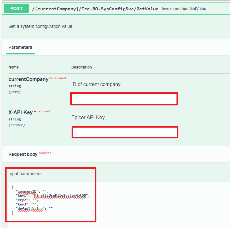

Oh, sorry. I forgot about SaaS. Not very familiar with what you have access to. The table Ice.SysConfig is not available in a standard BAQ …
Do you have access to Swagger? I just tried this call and it returned the value “false” as expected.
You should look up the last execution date. In my case, the task had been executed, but … someone had us execute a mysterious dark SQL script each time we upgraded our database. The script literally updated this parameter to true, to fix an issue with the Configurator module (a module we don’t even have). There is a thread about it on this forum.

It’s set to false @vingeance
