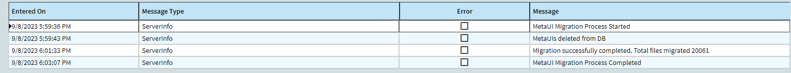

Conversion Workbench, run conversion 191.
Thanks for the quick reply @hmwillett, that fixed it.

Any insight into how long this will take to run @hmwillett @aball ?
COO is asking…
support said 0-5 mins…
Honestly, I have not paid attention, but up to 5 minutes doesn’t seem far off.
Looks like 5 minutes.
Thank you!
