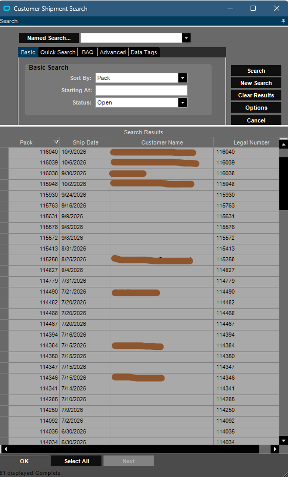

Orphaned Packing Lists display in Search, but not in a query
When we open Customer Shipment Entry and search for Open Packing Lists, several items show up in the results list with a blank Customer Name.

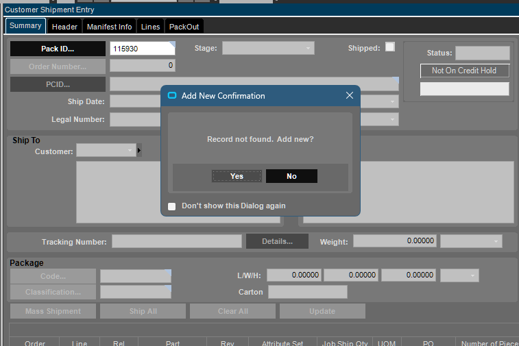

If we select one of those blank rows to open, we are brought back to the Entry screen with nothing at all pulled in. If we try to type one of those PackNums directly into the PackID field, we get the message that it does not exist:
None of those PackNums exist in the database, confirmed via both BAQ and SQL. I’m not entirely sure how they are being created in the first place, but does anyone know how I would remove these from the Search results list?

It turns out there was a post-processing Method Directive running on CustShip.GetByID that was causing those “phantom” Pack IDs to exist but not be able to fully load. The BPM has Custom Code looking for ShipVia information, but these goofy packing lists don’t have any so it seems to stall out.
I updated the custom code to account for a blank ShipVia, which at least allows the ShipHead to fully load so it can be deleted.
