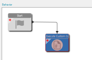

My code :
BO: Erp.BO.Receipt.AutoSetToLocationToDflt
Post-Processing
var RcptHead = ds.RcvHead.Where(x => x.Company == Session.CompanyID).FirstOrDefault();
if (RcptHead != null)
  var RcvLines = ds.RcvDtl.Where(dtl => dtl.PONum == RcptHead.PONum && dtl.Company == Session.CompanyID).AsEnumerable();
  if (RcvLines != null)
    foreach (var dtl in RcvLines)
      if (dtl.TranType == "PUR-STK")
        var Bin = this.Db.PartBinInfo.Where(pt => pt.PartNum == dtl.PartNum && pt.WarehouseCode == dtl.WareHouseCode).FirstOrDefault();
        //dtl.BinNum = Bin.BinNum;
        var view = DataView["Mass Receipts"];
      this.Db.Validate();
      this.Db.SaveChanges();

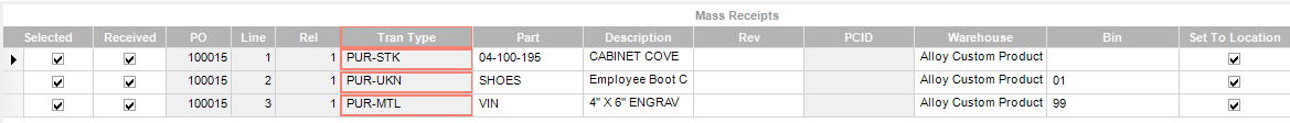

Before ‘Set All To Location’

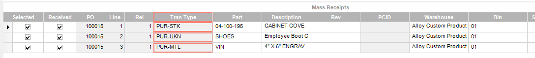

After ‘Set All To Location’

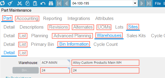

Part Bin Information that I would like to see populated in the field.
I have all the information stored on the Bin information tab within the part record. I pull that data at the Bin variable and attempt to set it to the view as this is event doesn’t submit the values rather validates.
