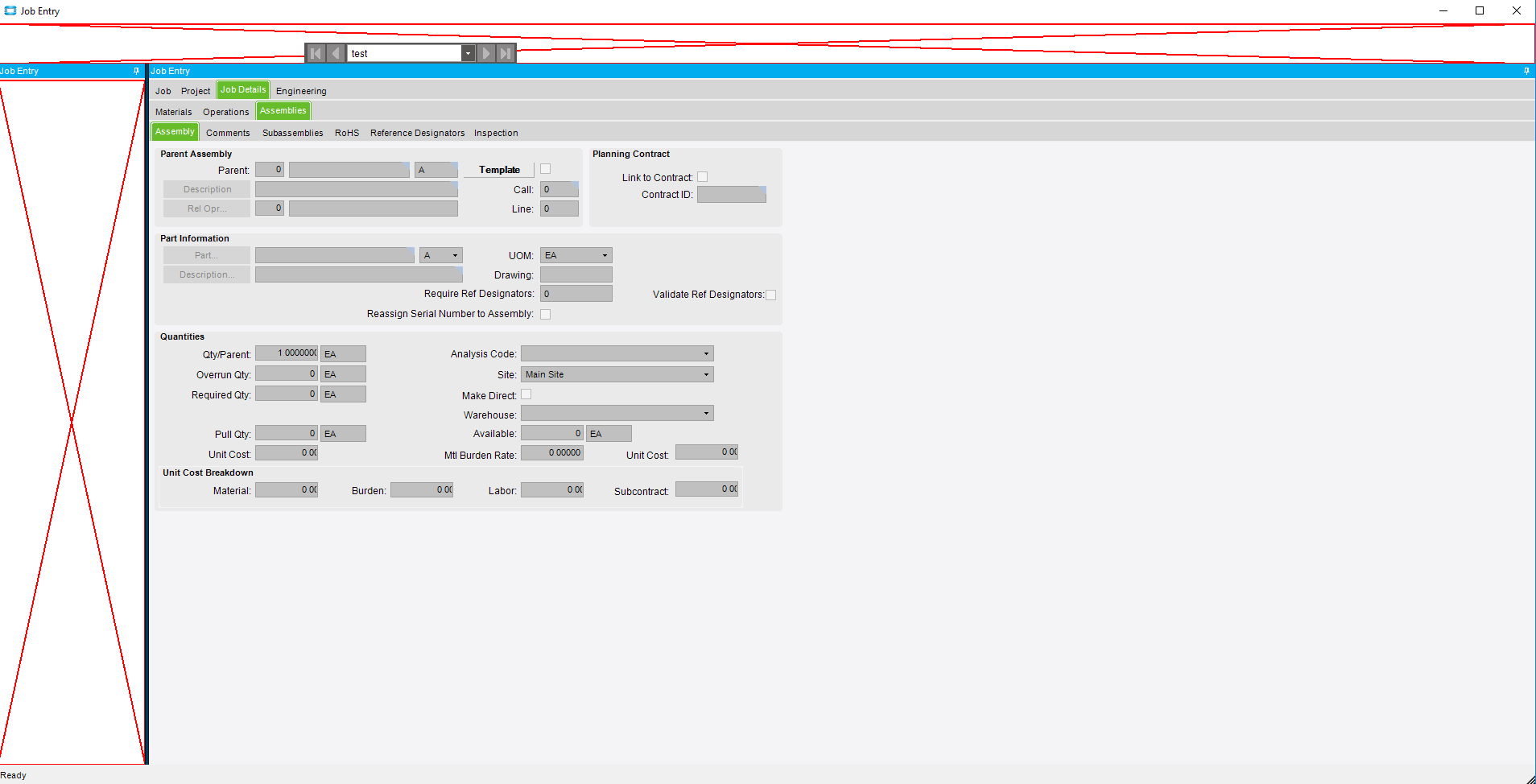

I am having some issues, and can’t figure out how to get it to work. I have a customization that only pulls in certain documents from the part and rev when using the get details feature in Job Entry. It works great, and does what I need it to, but in order to see the changes, I have to clear the form, then reload the job. I know that oTrans.Refresh is what I need, but it causes an “Object reference not set to an instance of an object” error. Here is my code:

Any ideas on how to get this to work?
