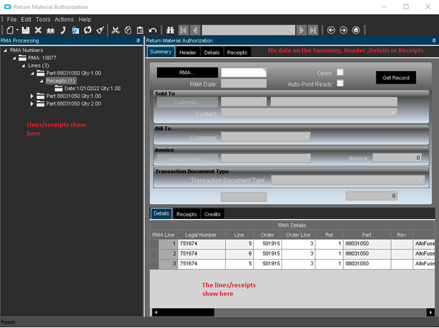

When I click the button, this happens:
RMA Summary
The data is showing up in the list views, just not the details:
RMA Details

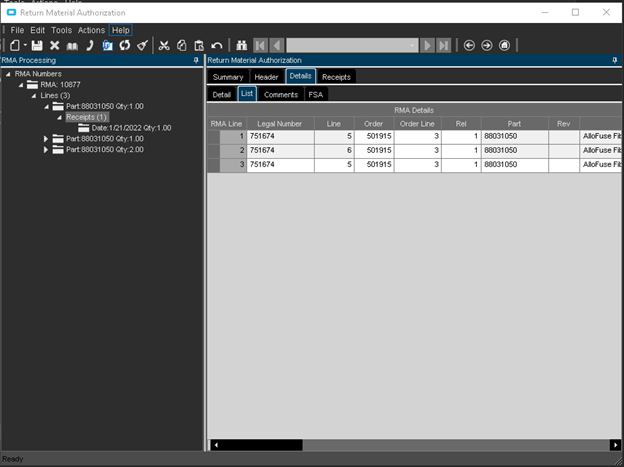

But all the data shows up on the details tab:
RMA Details List
My question is how can I get the data to show in all the applicable places? Am I missing some magic oTrans method that will tell the form that it needs to refresh the entry forms? Any help would be greatly appreciated!
