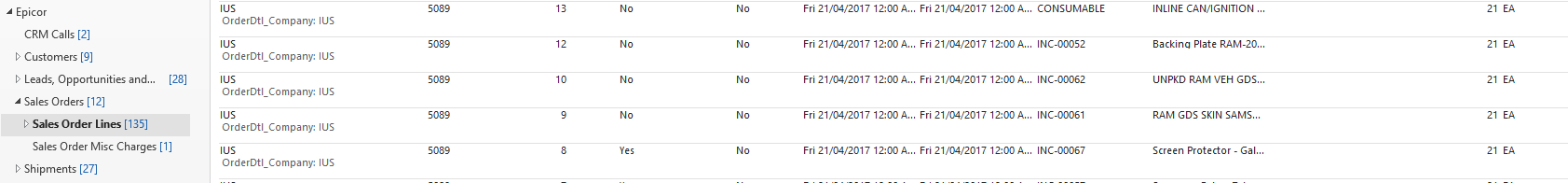

We use a module called information worker sold to us directly by Epicor.
It allows you to interact with Epicor data direct from outlook/word/excel.
works quite well for CRM, here is a screenshot to give you an idea
