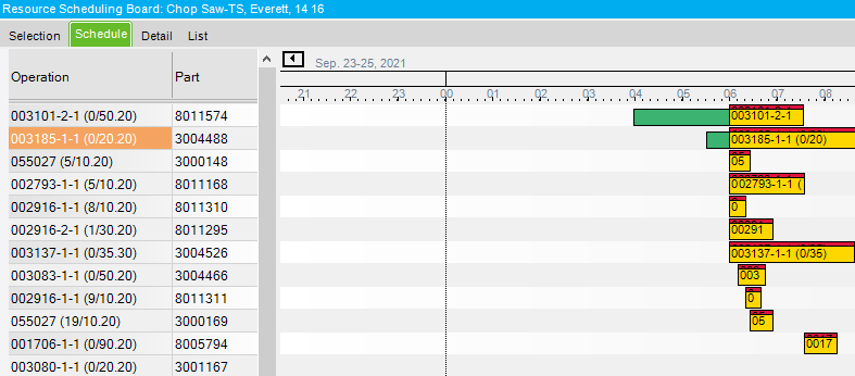

I’m trying to schedule finitely. Epicor is overscheduling resources from the very beginning of the schedule. I would understand overscheduling past my finite date or if a job was scheduled to end after the finite date, but these jobs that are being overscheduled are not.
This is from the resource scheduling board for resource M290.

So over the weekend, we rebooted the server and I tried to start fresh this morning. After running MRP with regenerative checked and the hours gap removed from my schedule, I get this for resource M290:
Not only are there still some jobs that are scheduled at the same time, but I have one job listed as starting on last Friday although I have everything checked to not allow scheduling in the past.
This is after running MRP. I have not ran global scheduling yet.

Example of two conflicting jobs:
