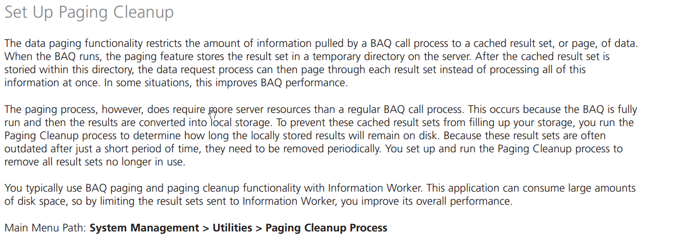

Under System Management > Utilities - there is Paging Cleanup Process.
What is used for? I have tried searching but, haven’t found anything.
The ICE Tools guide for Epicor 9.05 has a topic on this process:

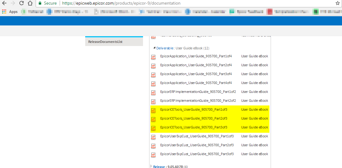

Links to the ICE Tools guide for E905:
https://epicweb.epicor.com/doc/Docs/EpicorICETools_UserGuide_905700_Part1of3.pdf
https://epicweb.epicor.com/doc/Docs/EpicorICETools_UserGuide_905700_Part2of3.pdf
https://epicweb.epicor.com/doc/Docs/EpicorICETools_UserGuide_905700_Part3of3.pdf
