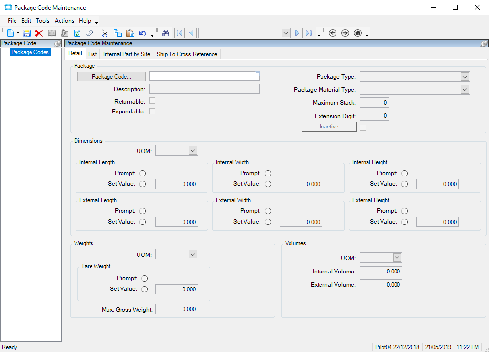

One of the things I did like about the package codes is the fact that form has a fair bit of the data that I thought you you would need to be able to define your dimensions, as well as weights an volumes.
That could well be the basis of a customization. Perhaps using a UD table to establish the rules based on your packages (i.e stacking priority, number of packages per layer etc)… Then use a BPM with custom code on packout.
