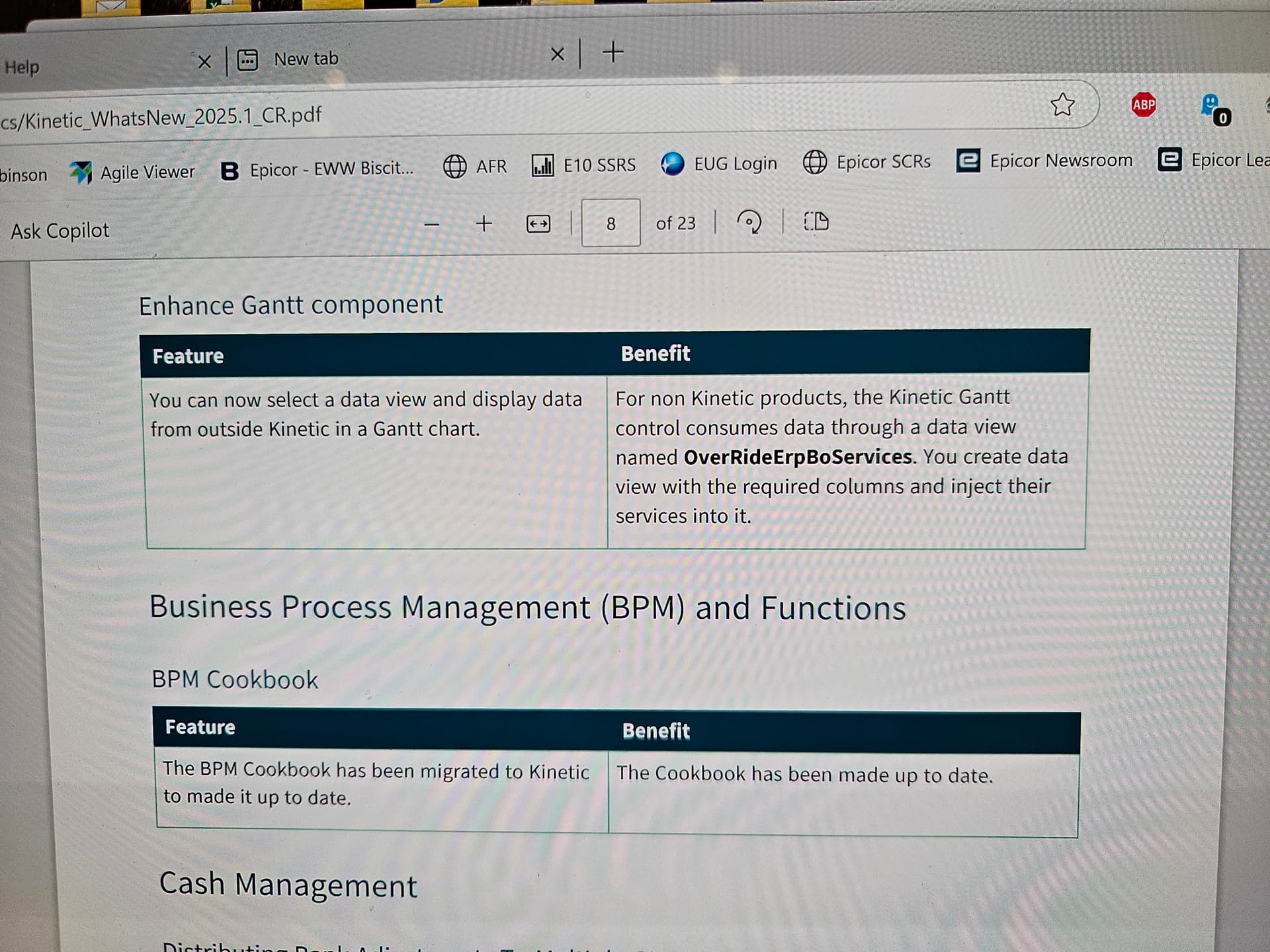

Lol - good memory @hmwillett . Yep, i popped this question on you outta nowhere. I saw a tidbit in the 25.1 CR release notes about using external data. Heres the snippet

I’ll have to play around with Gantt charts again after the next update. :slightly_smiling_face:

I have a 25.1 environment installed. I’ll play with it and see if it got any easier.
