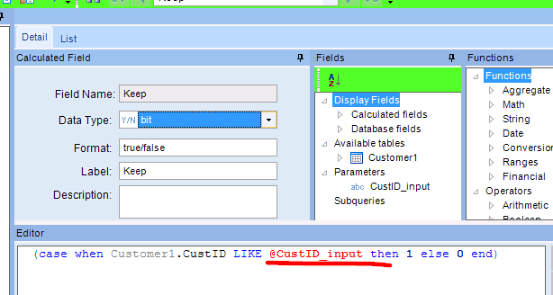

Make a sub-query that has a calculated field based on a parameter.
Link the sub query to your main query
Set Query Criteria for the sub-query
Now the calculated field will do it’s thing with the user enetered value. and the link between the subq and main querywill act to allow only selecting records where the calculation yields a desired result.
Thanks! I will play with that and see if I can get it too work.
It doesn’t have to return a true/false. You can make the calc field return whatever you want, and then set the criteria as desired
This was very helpful. One other thing to note is that the parameter has to be mandatory or else it will not show up in the BAQ calculation widget.
this :point_up_2:
Also cannot have ‘Skip condition if empty’
