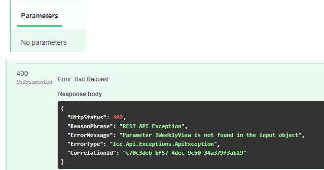

Parameter lWeeklyView is not found in the input object - Approval of Labor Entry
Kinetic - Cloud
Attempting to Submit a Header, Details, & Approve a Labor Entry.
Erp.BO.LaborSvc - SubmitForApproval
Rest help says no params are required
Also says it’s missing
Attempting the following

Notice at the very bottom:
        "PrimaryKeyColumns": [
          "string"
        "PeerTableSystemCode": "string",
        "PeerTableName": "string"
  "lWeeklyView": true
Thanks for the weekend reply. The issue I’m having is that this form isn’t available to debug in chrome so I’m relying on old tracing. I understand this is essentially the same process, but it’s somewhat still new for me.
My understanding is that when following a process you take the dataset from the previous step and pass it through to next step after changing the variables you desire. Apparently that’s either not the case if the previous dataset doesn’t include the necessary parameters, or Im missing a step.
It’s not always that straightforward.
What do you mean this form is not available to debug in chrome? What form are you trying to use?
Also, what tooling are you using? I can see your code, but that’s not standard function code, so where is this coming from?
What exact url are you using in Swagger, because that’s not what the endpoint should look like.
Just lay it all out like we’re 5 and we should be able to point you in the right direction.
Almost forgot. Welcome to the forum!
You’ll probably never leave. :rofl:
This ought to help you out.
That input object is not just the dataset.
It’s the dataset & a boolean inside another object.
    "ds": {...},
    "lWeeklyView": true

I don’t insist on REST. I’m more than annoyed by it. I’ll definitely look into building a function to get this resolved. Thanks for the advice and I will gladly stop beating my head against that wall.
Turns out I enjoy the pain. I was able to get it updating as desired. Just needed to append jObject1 with lWeeklyView, as you mentioned, and use that DS on the SubmitForApproval step.
