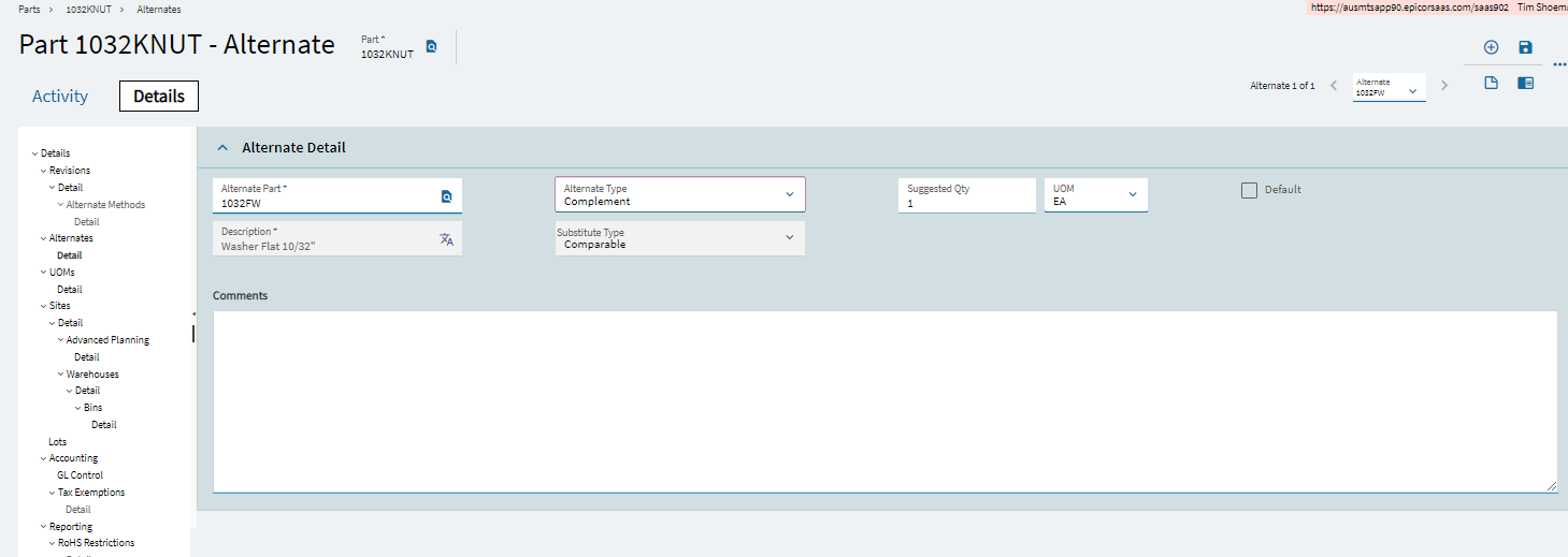

I think you are referring to COMPLEMENT parts… if that is the case, then yes, you can go into the Part Entry and go to the ALTERNATE parts (not alternate methods… that is something else). You can create a list of alternate parts, and specify that they are COMPLEMENT parts.
To do this, FIRST you add complement part number(s) (one or many).

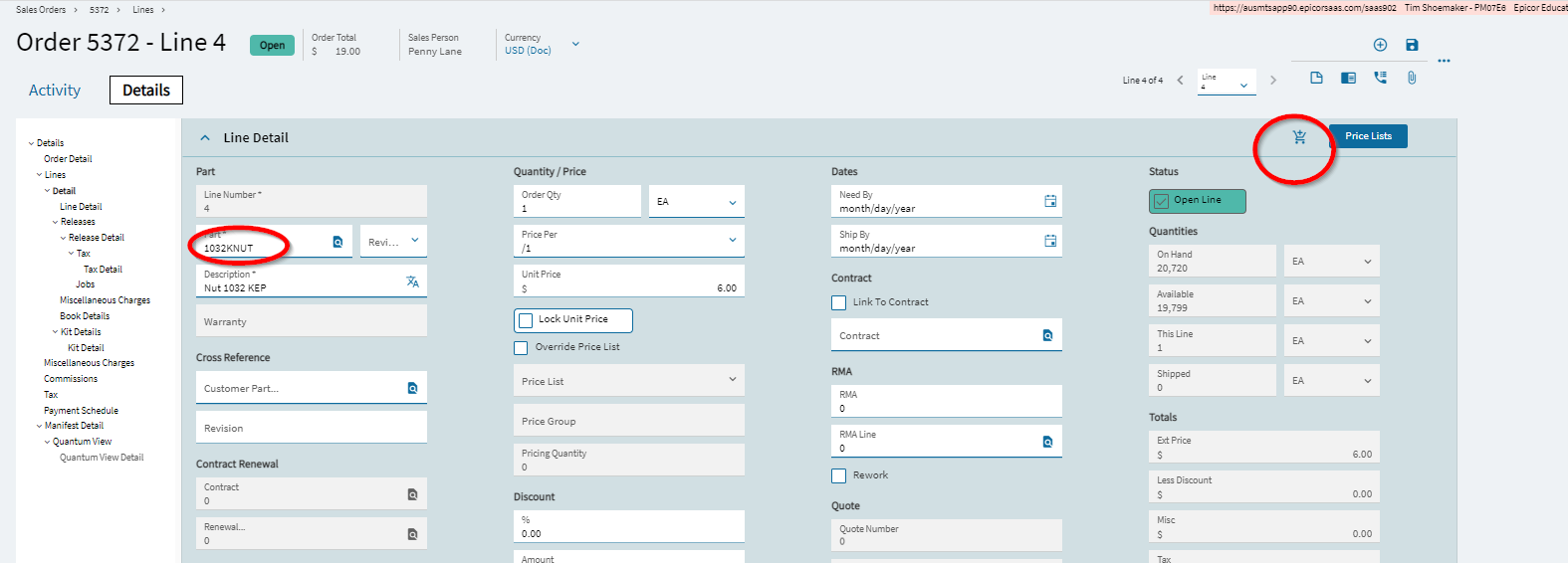

Then, in the Sales Order Entry program, after you enter the one part number, a BUTTON highlights on the screen for the Complement part:

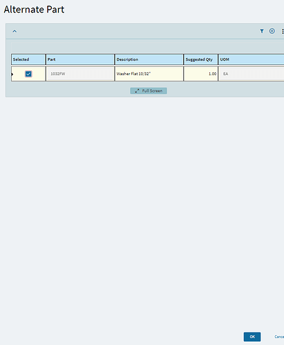

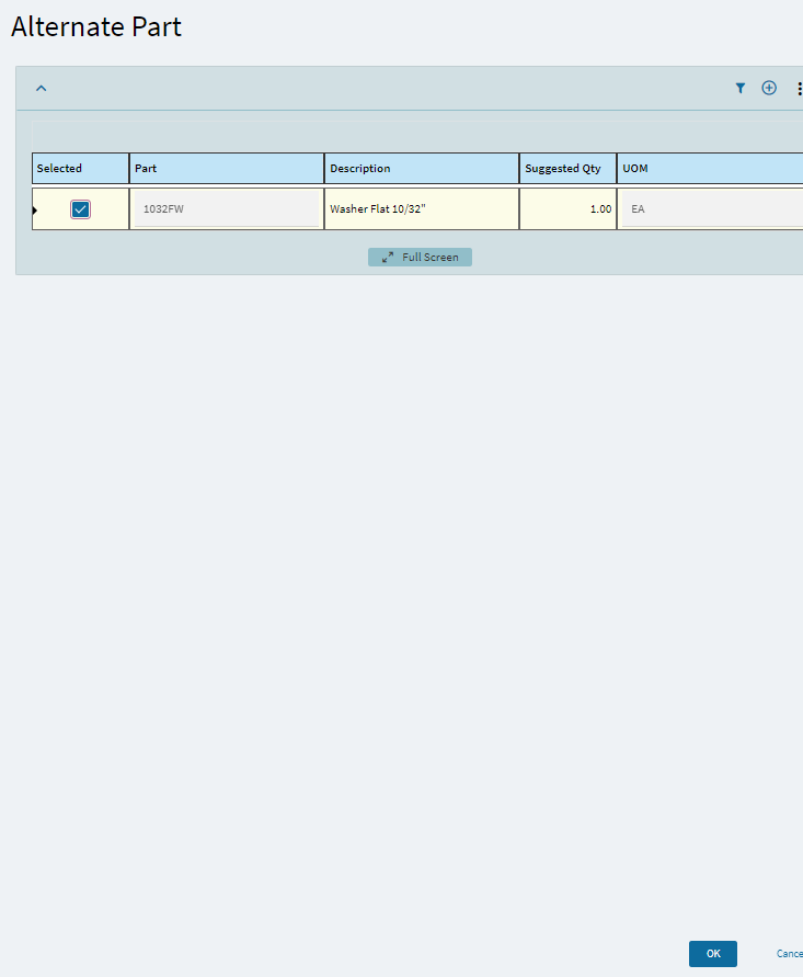

When you press the button, you will get a screen that asks you to order the complementary parts.

Hi Tim
That button is not obvious and could easily be missed.
