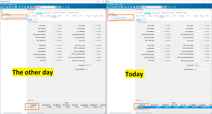

I have a part that exists in two sites but only has a cost in one of them.
:arrow_forward: Yes, each site has its OWN CostID, properly associated. I’m not new to that. We are talking about one oddball here.
Any thoughts on how to get a cost record associated with the other part-site record?
Backstory
I confirmed this today.
  1. Part existed in PDC site (and not MFG site)
  2. Someone did an RMA in MFG site for the part
  3. RMA itself does not create the PartPlant record
  4. But the RMA receipt does
  5. Yet no PartCost record gets created

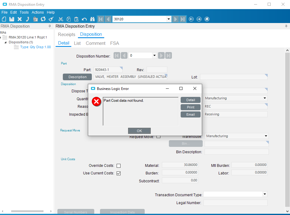

  6. Go to disposition the RMA, and you get this error when selecting “Use Current Costs” [Part cost data not found]:
you should submit this to support with your “script” on how to reproduce this. What you are describing is not intended, and is unexpected for the software. If you can create a PartPlant record without a related PartCost record, we have an error.
