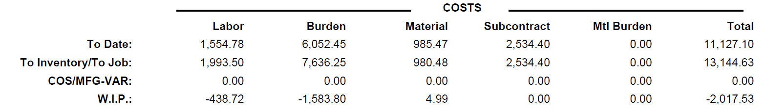

Looking for to understand a scenario where the costs received to inventory from a job are higher than the actual costs to date?

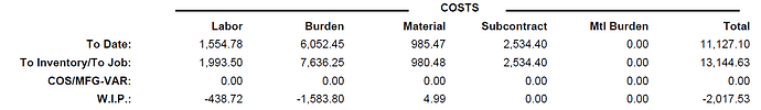

In the screen shot below from a Work In Process Report, the cost to inventory is $13144.63 which matches the MFG-STK transaction for that part record. However, the costs to date on the job are only $11127.10 resulting in a negative cost value in WIP?
No transactions have been reported against the job after the MFG-STK transaction occurred. The variance is only showing in labor and burden, not material or subcontract.

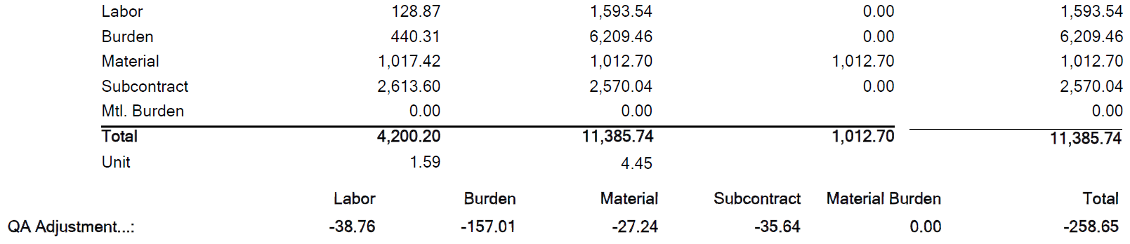

Additionally, this screenshot from a Production Detail Report for the job shows a total which matches the “To Date” value above of $11127.10 = $11385.74 total minus $258.65 for QA scrap adjustments.

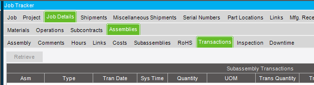

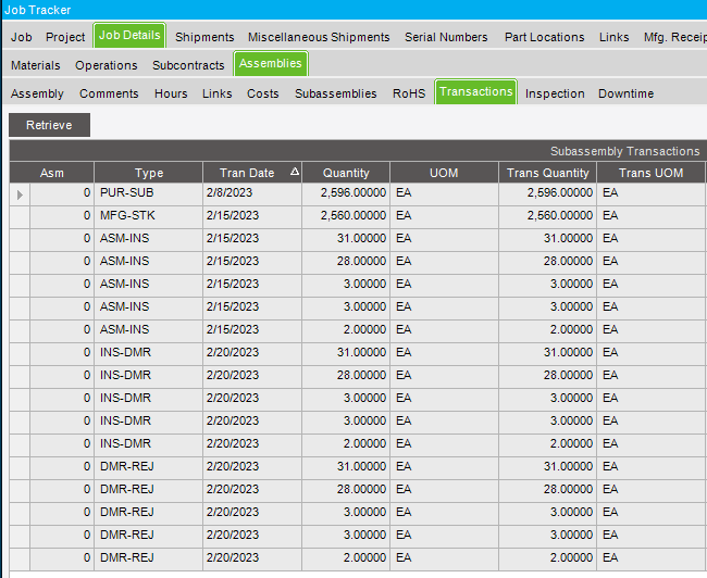

Andrew, try running the Start Date of the WIP report back a year or two. Does this clean it up. Just wondering if someone entered a wrong date on a transaction. Also what does the Transactions tab show in the Job Tracker for this job?
Hi Todd, running the WIP report with an open start to capture all transactions yields the same results. The Transactions tab on the job tracker looks like below where there are several transactions after MFG-STK but the various ASM > INS > DMR transactions are accounted for in the appropriate scrap buckets.
