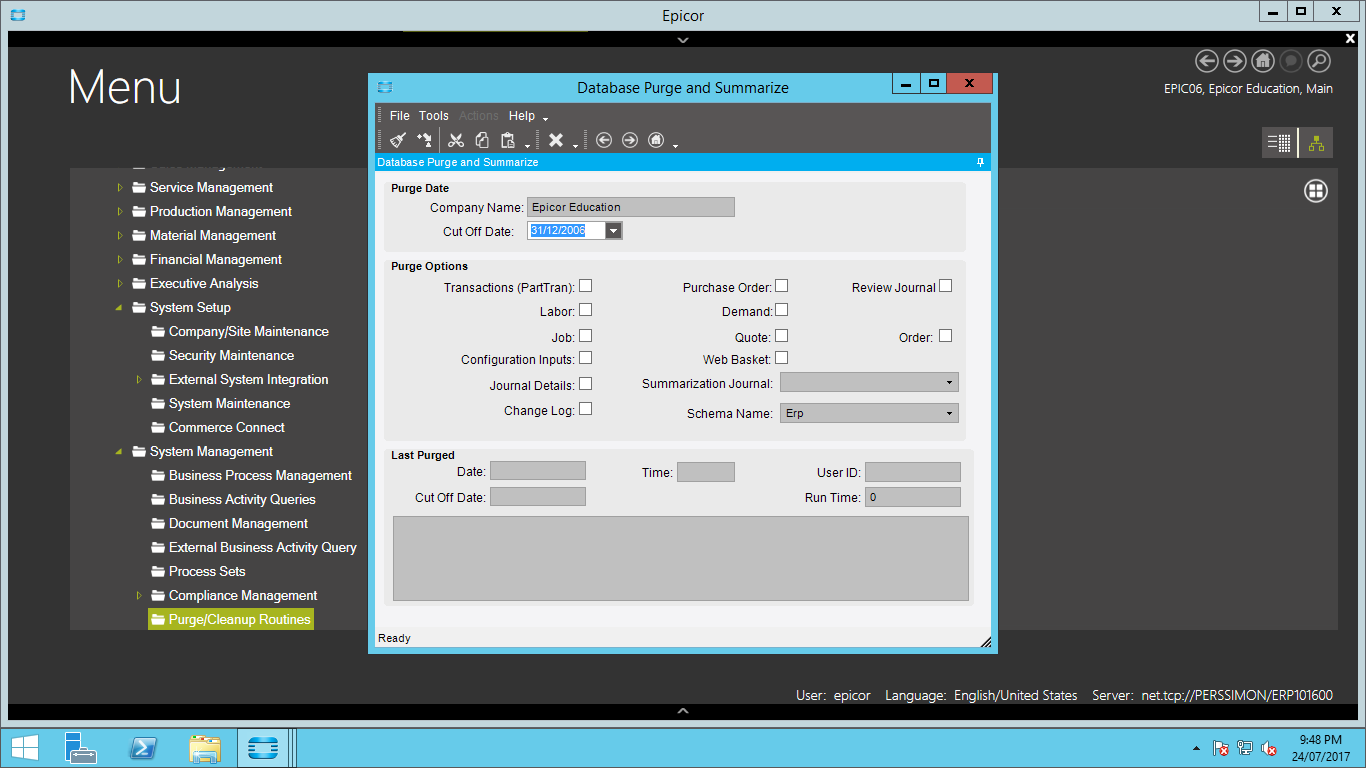

That’s a good question. I am guessing that you need to do a Database Purge and summarize of any related transactions first…and of course backup first…and test in your test environment before performing on Production.

I misread your question. I read it as you had run the delete via the DMT… Matt is correct the DMT will error out on those parts that have business object referential integrity, although it really should be in the database design.
From my post I was assuming you had a lot of parts you wanted to get rid of (14000 odd) and they had old transactions that you were happy to remove from the system. The purge may or may not help except for older parts that you are happy to remove the associated transactions related to the relevant parts…I hope that makes sense.
