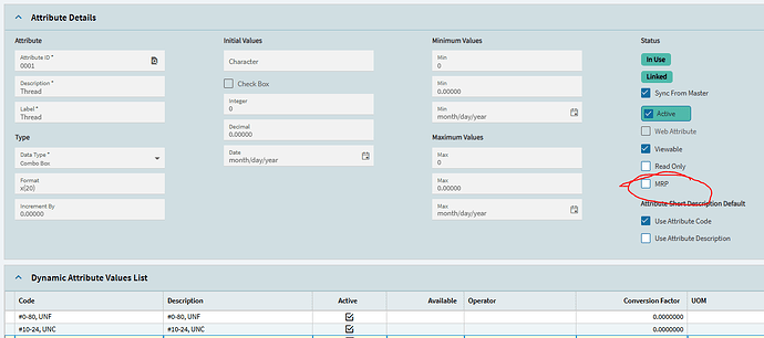

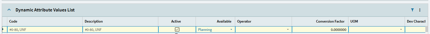

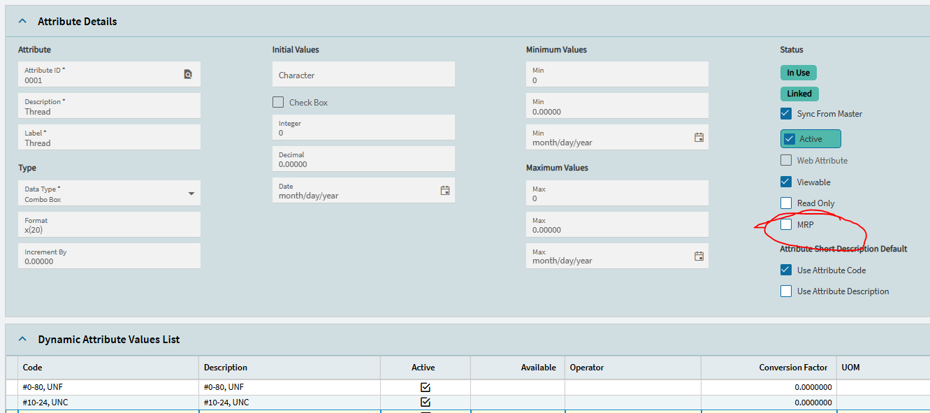

This is a great use of dynamic part attributes. Create 2 planning sets and you are good to go. refer the the right attribute set in each masters. An attribute class with a single attribute is probably the best case scenario for tracked dynamic attributes with planning sets .
I am curious about this as we don’t use dynamic part attributes. Can you tell me more? Or do you know which user guide might have this information? Thank you!
you need to have advanced UOM, if this is the case, create a attributte class with type basic. you then create a single attribute master of type combox box. you then add those choices in a list.The attribute master need to be selected as MRP . the attribute , in the specific class, need to be available as planning set . You then add that attribute set to your part and select track attribute . THe part is now 2 parts in reality but under the same part number as different planning set . you would need to change the PO report to show your attributes.

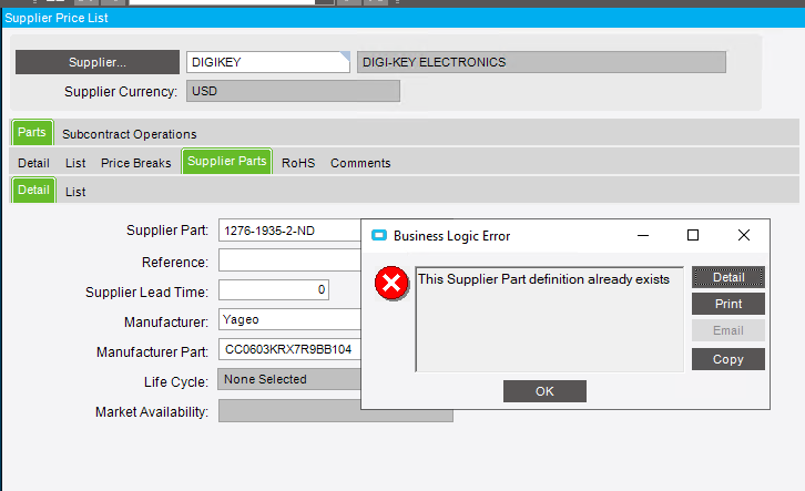

I am trying to associate multiple manufacturer parts with a single supplier part via the supplier price list module and it’s not allowing.
