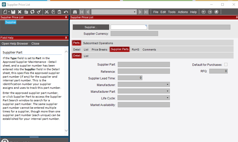

I think you can manage this using supplier price lists
As @aosemwengie1 said, yes you can apply multiple supplier part numbers to the same internal part. In fact you can go one level deeper and assign a manufacturer and manufacturer pet number to a supplier part. This means that you can have your part 123 that points to 3 different suppliers. Those three suppliers could actually have more than one part number that point to the end manufacturer parts. This is especially important in electronics where there are a small number of manufacturers but a large number of distributors whom you buy from.
