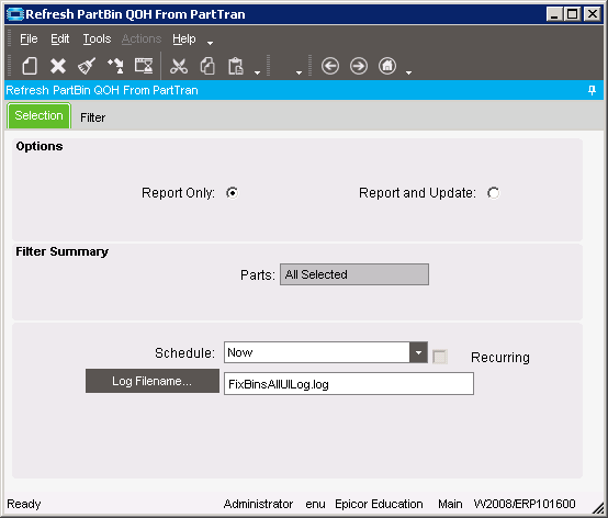

I thought stock status calculated qtys on the fly from part trans
and part tracker is using data from summary tables - which can get out of sync
So just wondering if you have already verified/refreshed your summary tables and/or OnHandQtys?
