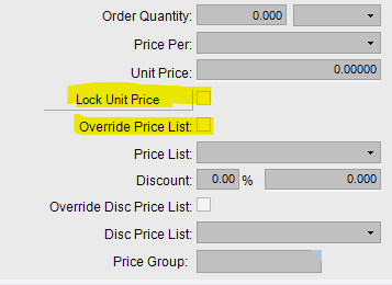

No love for Lock Unit Price or Override Price List?
it seems like i have seen the “lock unit price” get turned off when certain things happen like changing a part number, so it is not always guaranteed to work.
Seems like enforcing Lock Unit Price or Override Price List through a BPM might be less work than a BASE BPM but you know how automagical things are hard to enforce!

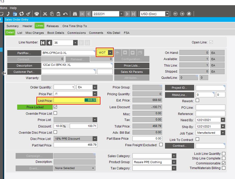

So I have the part and the one in the example below is BPK-CFRCA12-XL and the Unit Price on this part is $1039.50. IF they order it as the Rev WOT I wanted to subtract the $480 which is the current unit price on the TR-9ELK that is included with this kit. The image below shows where the customer’s discount is being applied to this modified price. Again there are 315 kits with this setup so trying to find an efficient way to get this done.
