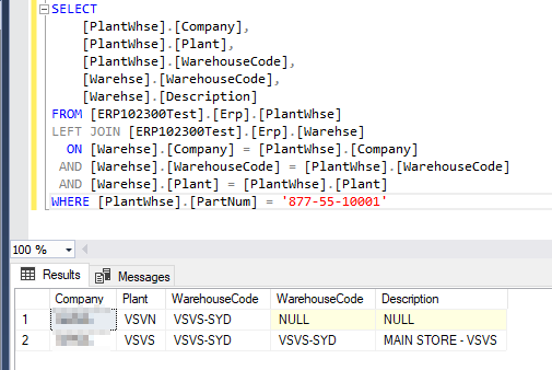

Some additional context and info:
- The part exists in the DB, it can be queried and seen in a BAQ / SQL
- So far I have not been able to identify anything that stands out as different when comparing Part table entries between the part that throws these errors and a good part
- You can search for the part and it shows up in the list but opening the part in Entry / Tracker will cause the above errors
- There are no change logs recorded against the part in over a year
- I have disabled all custom BPM’s we have on the Part method’s and we still run into the same issue
Hoping someone else has come across this and has a solution or can shed some light on troubleshooting ![]()
