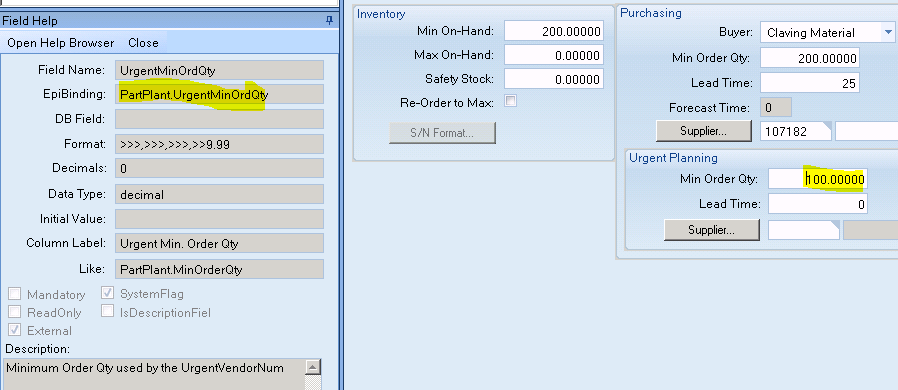

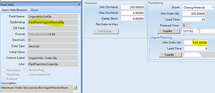

I don’t have access to 9.05.702A, but in 10.1 and 10.2 it’s PartPlant.UrgentMinOrdQty. There is certainly a DB field for it somewhere, if you highlight the field on the Plants tab, go to Help, then Field Help, and click on Technical Details it will tell you the DB field name.
The Field Help screenshot below doesn’t help since there isn’t a DB field.

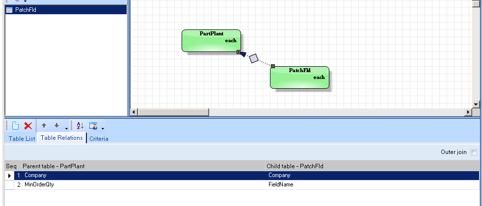

I did find the field in the PatchFld table but not sure how to link it up in the BAQ table relations
The value in EpiBinding is the field in the database… PartPlant.UrgentMinOrdQty.

You’ll want to add a table criterion on PatchFld that requires TableName to be equal to the specified constant, PartPlant. In 702a I’ve verified that PartPlant does not contain the field, so I believe you’ll find it in PatchFld, and put it on your list of things to check after you upgrade.

How do you add a table criterion in the BAQ?
On the Phrase Build tab, click on your table (may need to do this more than once; it should have little “handle” blocks in the corners. Then look down in the lower area for another set of tabs and click Criteria. Then just to the left click the New icon (not the one at the top of the screen) and choose your fields.
Before I get to the Criteria tab, how do I set up the Parent-Child Table Relations? Which Parent-Child table should I be selecting for the PartPlant table and for the PatchFld table?
What you show in your partial screen shot is a good start. However, there is a field in PatchFld called ForeignKey, in which you need to match-up with whatever the key is, in PartPlant. However, if there are two or more key values, then it is a tilde-separated list and I’ll drag my feet here in case someone else has experience linking PatchFld to PartPlant.
