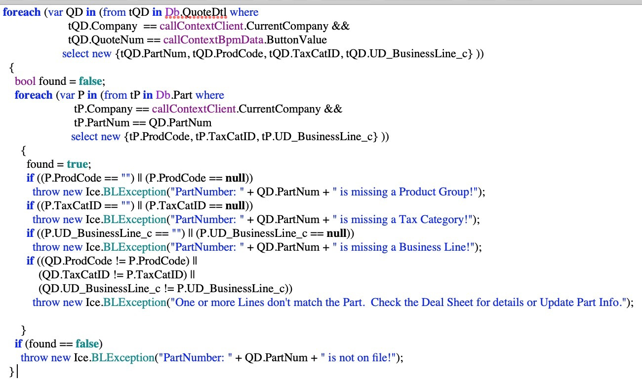

Our company has a BPM that doesn’t allow an order to be closed until the part exists. We allow the part to be entered, then wait for the part to be entered in Parts.

Looks like I mis-remembered which area the check was done, it’s done when the order is created from an opportunity/quote. So it would be before invoicing. For this pre-proccessing BPM we just set the button value to the quote number, then did custom code:

as @MLamkin said, companies that want to disallow this FEATURE of Epicor will typically create a BPM to prohibit it. If you are getting an error during shipping/invoicing when using a Part On The Fly (POTF) that does not exist in the part master, then you should report it to Tech Support.
@timshuwy I understand what you’re saying. We want to warn users when they enter a part that doesn’t exist in part master.
Just a warning? You could check that in a Preprocessing Method Directive attached to Update. That will check when they save the Order. (no extra button required). What we do instead is use an Order Deal Sheet (embedded dashboard) which shows all the data and highlights in Red, the part numbers that don’t exist in Parts. That way they know which ones will reject eventually, if not fixed. (usually the people entering the parts are not the same ones that use them on orders)
