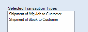

My thought would be a BAQ with Part vs PartTran… tran types MFG-CUS, STK-CUS, etc.
Use TranDate to filter.

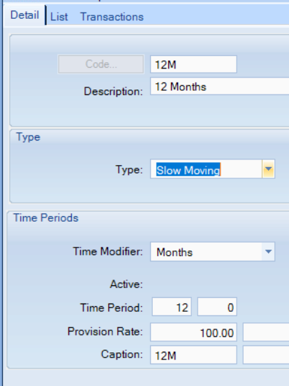

There is a slow moving stock report which I think does what @dcamlin’s BAQ would do. Do an Provisioning code like below. In addition to slow moving there is Excess and Aging, but I don’t know the difference.
Many thanks Greg
