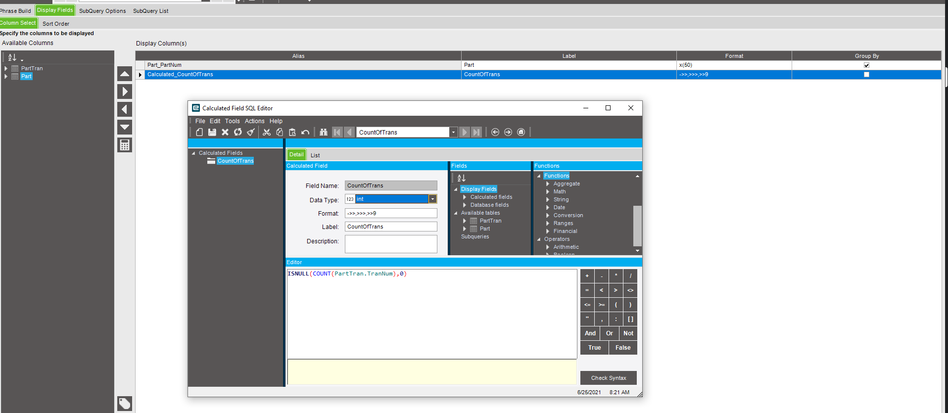

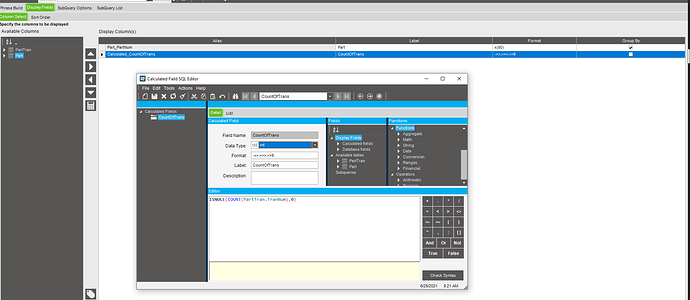

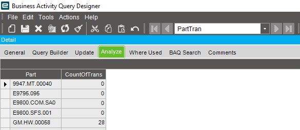

Hello, you could make a BAQ and do a calculated field on the PartTran table for a for a count of transactions. Something like this:
The only thing is you might have to do a date parameter for SysDate unless you wanted to bring them in as columns.
When i did my BAQ’s i would use the MAX(PartTran.TranDate). The count of transactions on a part is irrelevant if the latest transaction occurred in 2004.
Thank you both for your help! I think your custom suggestions should work for us.
