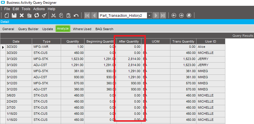

Did you ever resolve this? I am having the same problem. Trying to recreate the Running Total in a baq. “After” quantity seems to match up with running total value, except when transaction type = STK-CUS. Or MFG-VAR.
Then I seem to get a beginning and ending quantity of 0. Hmmm.

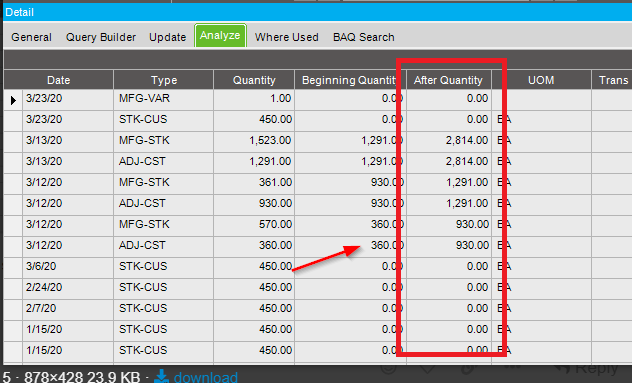

This is the boxed version that we use now on the same part number as my above baq. What is confusing to me, is that the begin qty is defined by Epicor as the on hand quantity before the transaction. So with our STK-CUS transactions, I am unsure why the begin qty would be 0, as we had parts on hand.

If I were to get the “signed” TranQty programmed correctly, and used (BeginQty + Signed TranQty) it looks as if it would just try to add it to the begin qty, which reads 0 - for these STK-CUS transactions.
This is what I am noticing. We had 2,364 on hand before 3/23 STK-CUS transaction and the begin qty reads 0. Hmmmm…

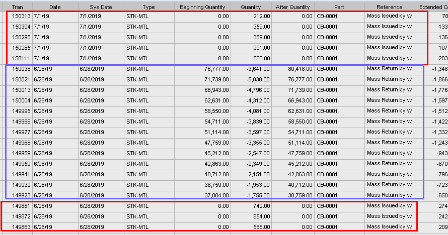

Issuing material to a job creates a STK-MTL with a positive TranQty, and the Before and After fields are always zero. (Red rectangles in BAQ of PartTRan below)
While Returning material from a job creates a STK-MTL with a negative TranQty, and the Before and After fields have values.(Blue rectangle in BAQ of PartTRan below)
I’d say the Before and After Qty fields can’t be used for running sum.
